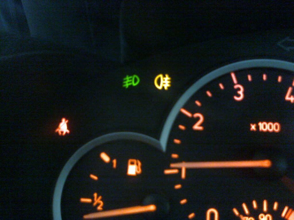

This is a pic of my cluster,and as you can see I have the 2 fog lights icons on,for the front and back,the front don't work,but the rear is working fine.
So is there something have to be checking inside the car (BSI)fuse or something missing???

12 volts at the connector in the fuse box?
