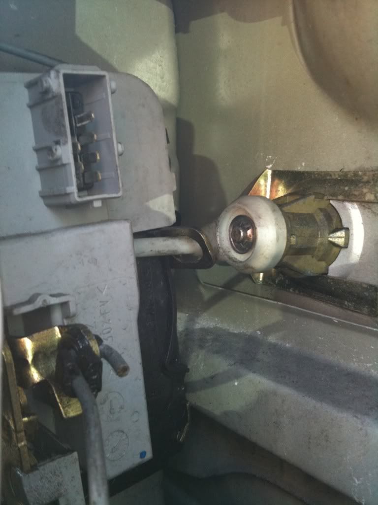

I'm just changing my solenoids over but I can't see how to remove this White rod that connects to the outer door lock. In middle of the pic
In the scrapyard when removing the solenoid I just snapped it but obviously can't so that on my car lol
Stuck, sitting in the gravel outside my house stuck lol

Pull the metal 'U' shaped clip off and it pulls out. Slide it to the left in the pic.

PostPosted: Sat Sep 03, 2011 7:57 am Up
Yes, done it plenty of times Wink
PostPosted: Sat Sep 03, 2011 10:14 am Up
Do as CD-530d said,take the lock out,and it will go out easily,it's a lock,that is why you are stuck
