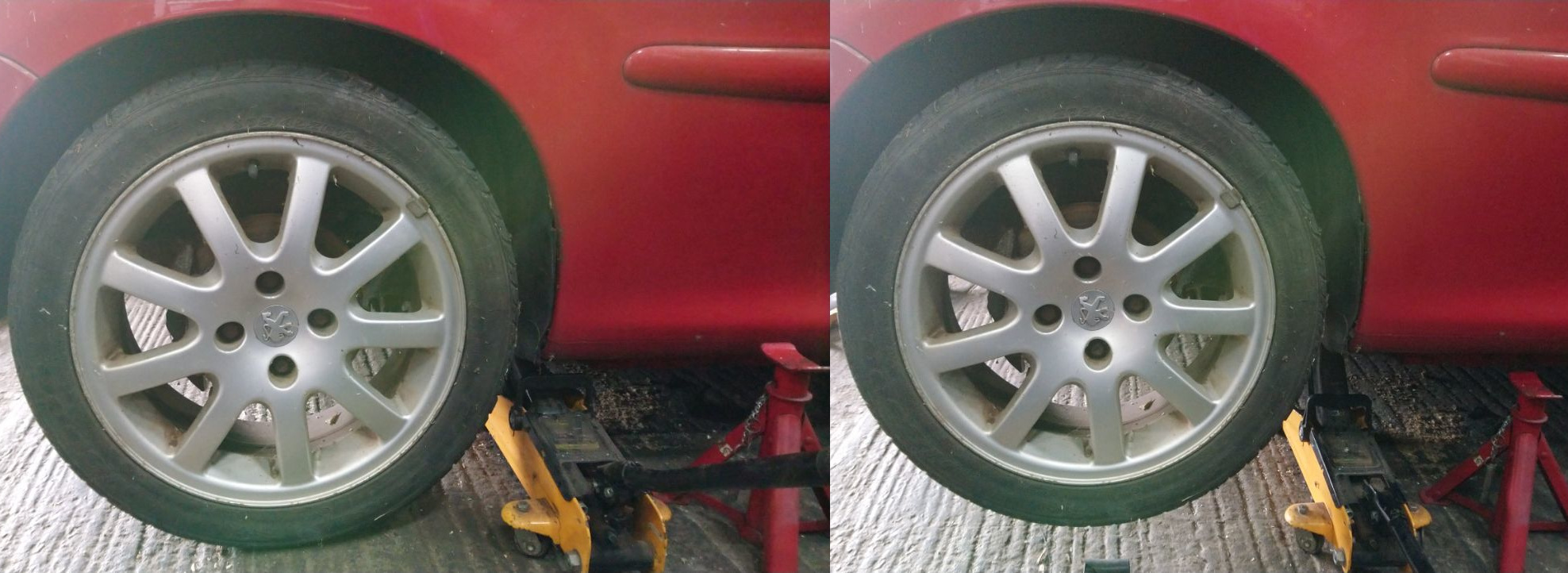

Alas soon enough as I maneuvered her into the bay, the steering became stiffer and I knew far too well the pressure sensor gave up on this one too (trying my best to keep the double entendre at bay here). Shut the engine off immediately and started mopping up the spillage.
As I am a glass-half-full type of person, could comfort in thinking that hydraulic fluid spillage will prevent the engine bay from rusting:))

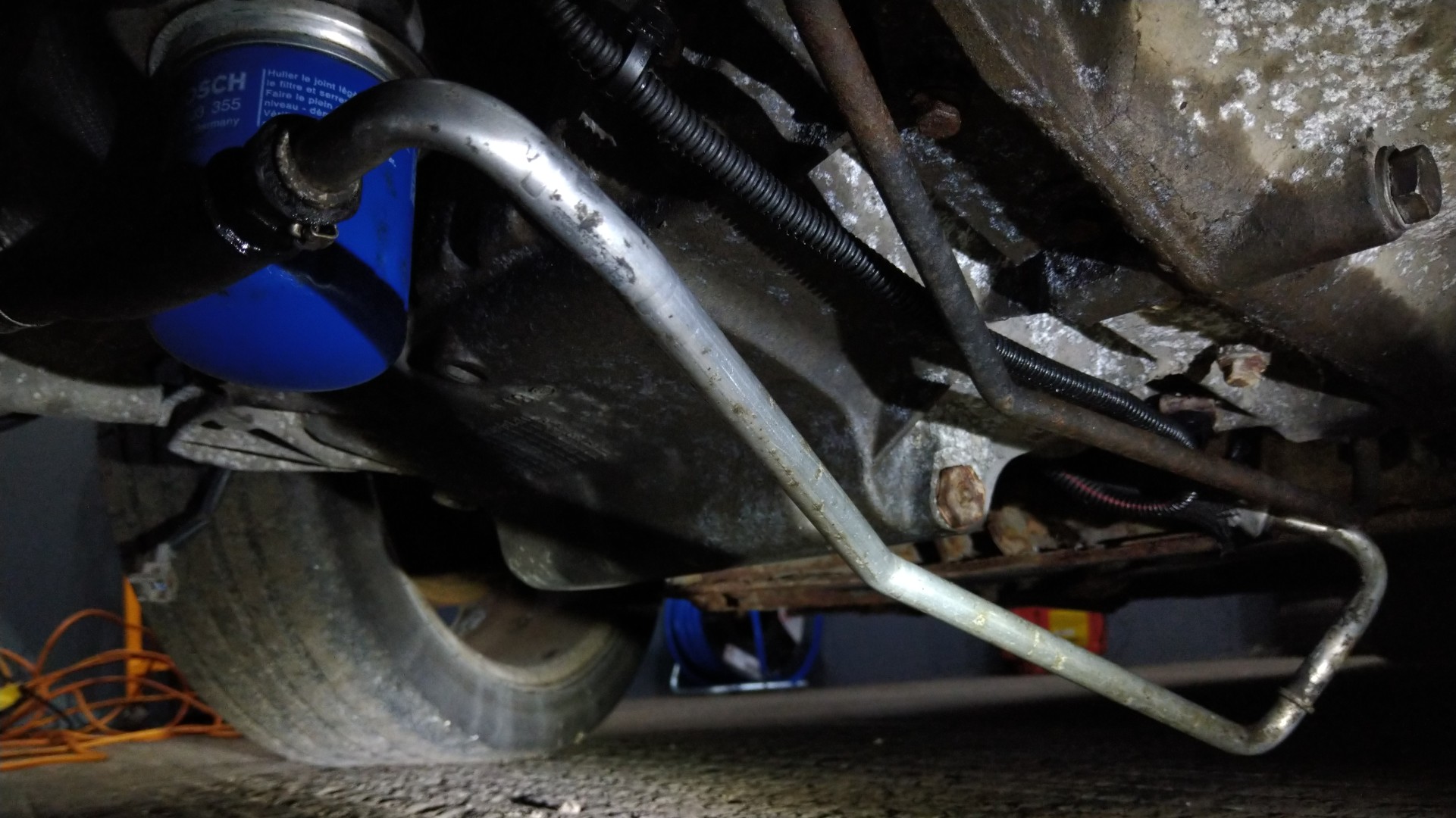

Seems the new PAS pressure sensor has a replacement part number of a reworked design, no wonder why!
There was however a distinct reason why this blowout had happened: the low pressure piping must have gotten mangled somewhere in a recent past, and made the overall pressure too high in the system:
Capt Hindsight says one shouldn't steer the wheel left-right-and-centre when some dubious pipes are hanging off the car (when I only glanced at them once, didn't occur to me they might be bent, thought they were just unclipped..:))
What was an experimental way to straighten them back, was to warm the engine (and PAS fluid), then ask a mate to keep steering the wheels from full lock to another, while blowing a heat gun into the bends, and slowly working the aluminium back to where it should be. Here's the result:
Now just to clip them back in, and start a mileage counter:))

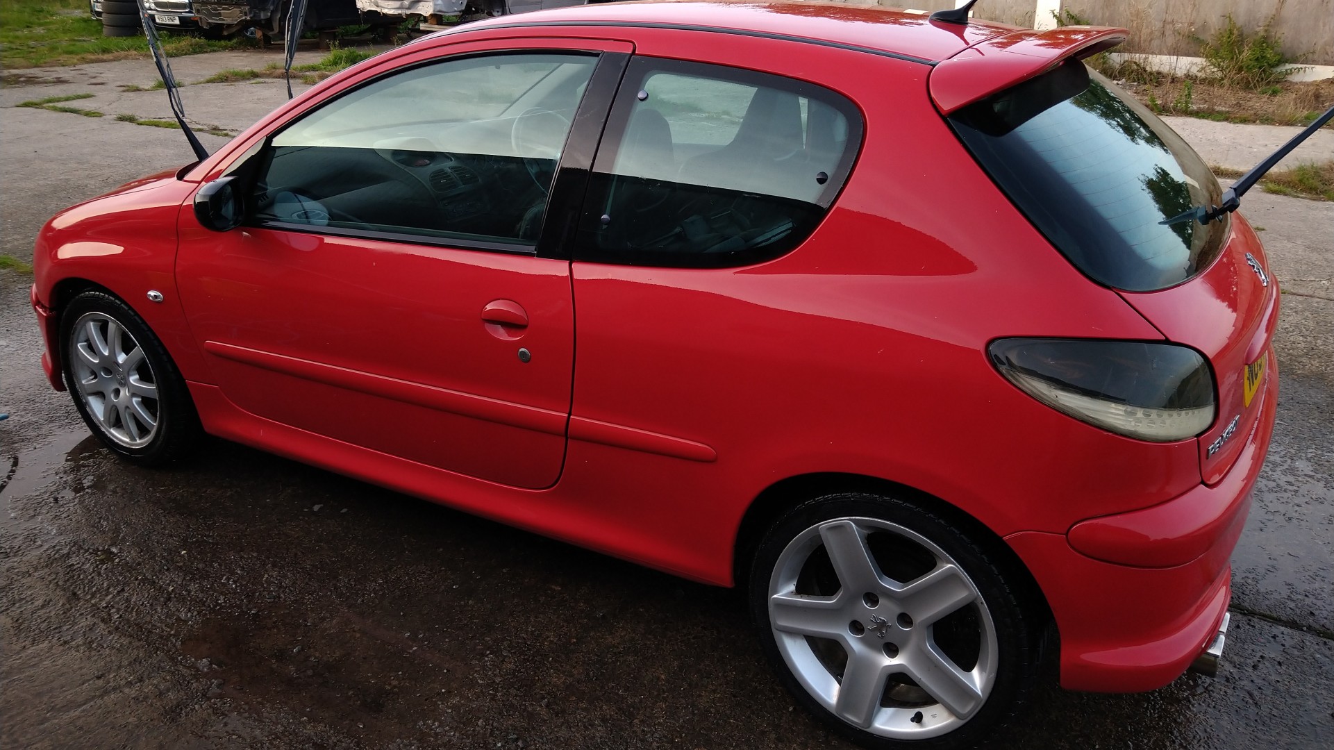

Plastic parts such as rear bumper have the dreaded lacquer peel:
Capt Marvel or Spidey colour theme?:] Anyhoo, deep paint correction will be needed:D
Those parts are being prepped for a re-lacquer (I hope not to ruin it this time:)) including the boot trim
Looks like it's been ages since I washed a light-coloured car, which'd sat for months. The difference is uncanny just after soaking in chems and a bit of pressure washer (the bottom part of the photo):
Really chuffed how she cleaned up
Can't wait for the paint do, but that's been postponed for several weeks:/

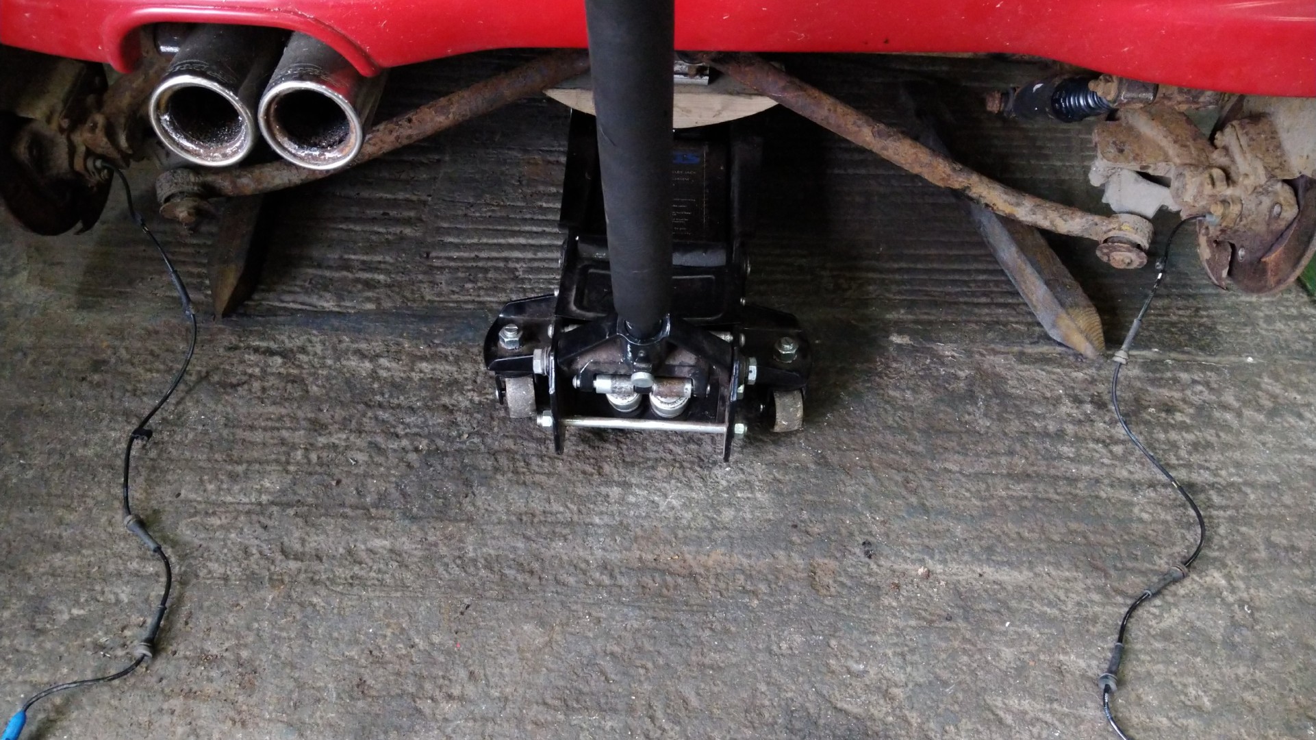

Happened to visit Ryan's Aladdin's cave in Norfolk to snap up a rear axle.
Out with the old, in with the old!.. Plans are to refurb one properly in the near future, as this one might be on its last legs (or arms) too
This marks my 4th swap across three 206s (if you're that bothered, read all about it here, here, and here:).
This time I've learned from the past mistakes, and managed to not bend any brake lines as I maneuvered the still-umbilicated calipers and handbrake cables around the arms of the replacement axle:)
'twas a good time to adjust the exhaust (since it had to be removed anyway), and tick one off VorTechS' checklist (#09 actually, the hangers were of the right size, it's then the clamped joint that sets the orientation)
This very old clamp fell apart while giving a stab at undoing it (expected):
