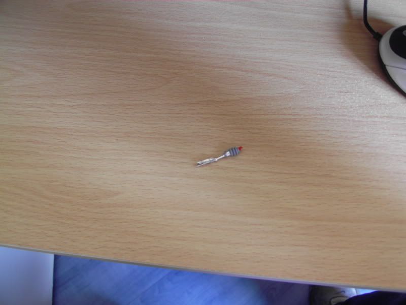

PostPosted: Fri Jul 08, 2011 3:19 pm Up
Mine was a dodgy wire at the big connector. Speed sensor isn't difficult to change.

Mine is not the same as the one in the pic there, unless that is a pic of something different. The sensor was a b*****d of a thing to get to as well, buried properly out the way.
