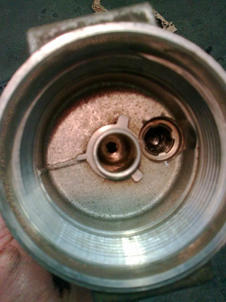

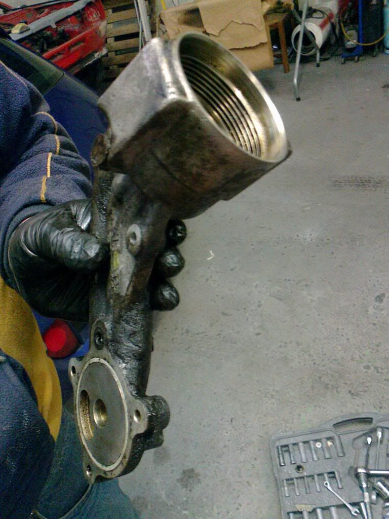

Once I got the right filter, I started to clean out the oil filter casing. I soon relised that it was full of black mushy residue because of the ruined filter, so I decided to remove the casing from the engine block and clean it out thoroughly -
The centre hole was fine and wasn't blocked, but the hole on the right was full of the old filter element bits. I thought it was completely blocked and tried to unblock it for ages until I relised it was a spring loaded non-return valve Rolling Eyes
Once I cleaned it all up I fitted everything back together and the car now runs a lot better.
