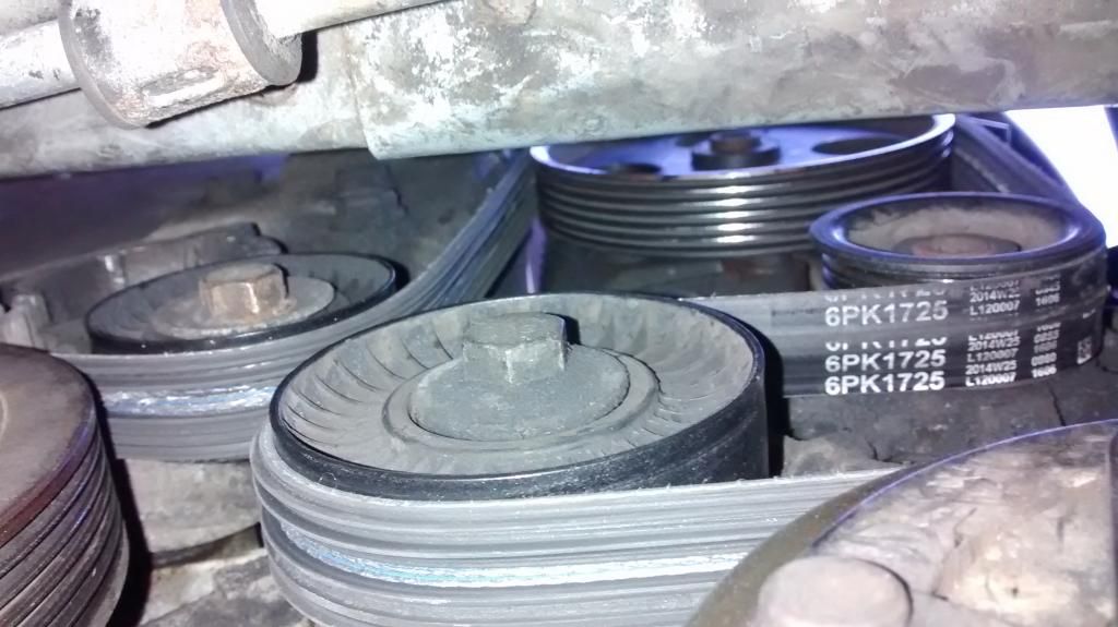

Just been out to refit the belt and found that I have about 3 inches of slack Sad

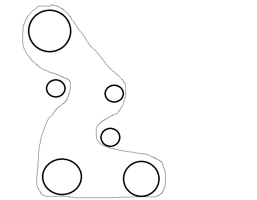

I have routed it correctly, and none of the components appear to have moved (alternator, Ps etc) but I am absolutely stumped as to how I can end up with 3 inches of slack on the belt. The tensioner is in place and working. The routing is as follows...
Yet I have 3 inches of slack. surely a belt would not stretch like this?

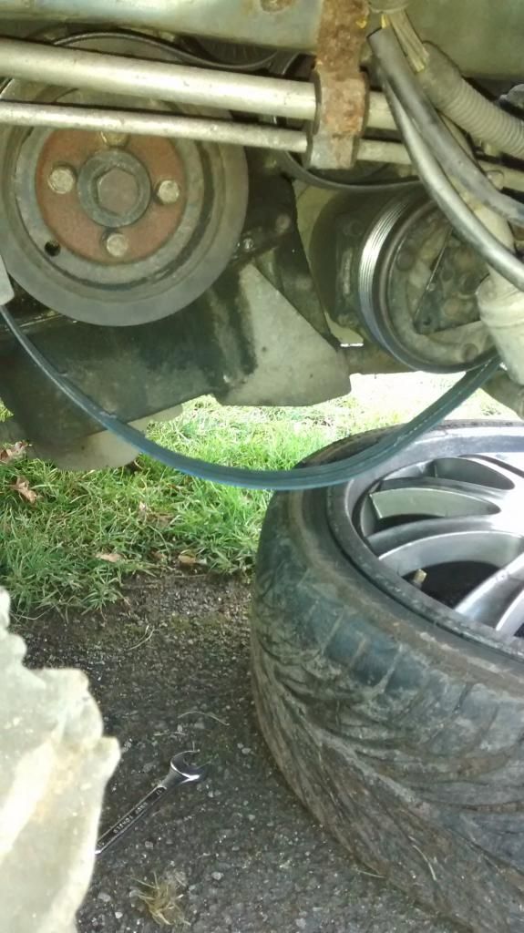

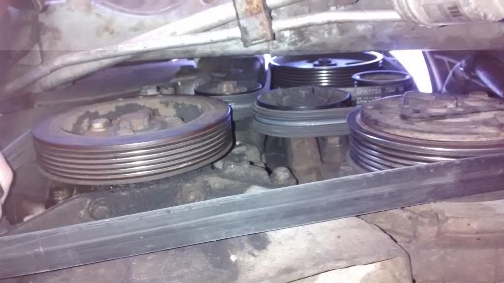

Tensioner flicks back strongly, yes (my knuckles have the grazes to prove it), The gti I have has the power stearing and the ac. Old one, a 'V' reg.
I have tried to take pictures, here you are. I also tried to make a quick diagram in paint. Hope these help as this car is my daily driver and Im back in work Monday so need to get it sorted by then...
This is the same aux belt I fitted about 2 weeks ago. you can see the missing central 'groove' caused by it jumping off.
This is the routing I have used...
I am lost as to why it now has 3 or more inches of slack. you can see just how much in the first picture. you can see it looks like there is a cog missing, but all rollers and cogs are there. Alternator has not moved, not has power steering pump. And even if they had, to take up the slack would mean they would have have to have moved hugely. Sad

Belts on wrong
Check top diagram
www.peugeot206cc.co.uk...bbm7k3.htm
Work in Progress
Steve206
PostPosted: Sat Jan 24, 2015 9:16 am Up
Posts: 2721
Last 2 diagrams on that page show correct layout. You want 2nd pic with aircon, the diagram your using is for the 1.6
You should have to put a fair bit of tensioner on the tensioner to give it slack. I'd use a new belt as well.

You sir, have just earned yourself a pint Smile
Thanks. Working fine now. although the mystery of the stripped 'tooth' in the belt remains...
