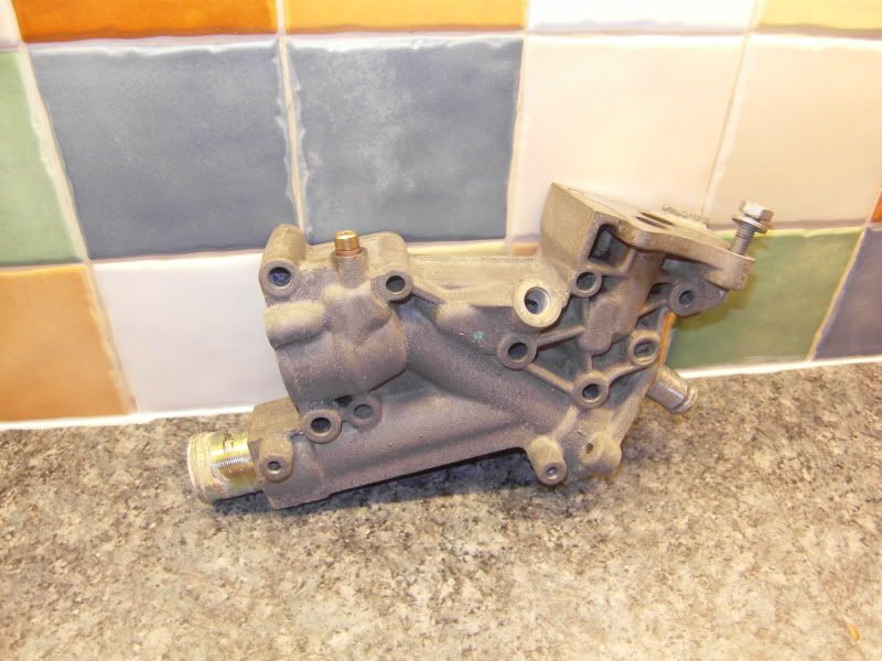

Bought this thermostat housing from Indigo GTi...

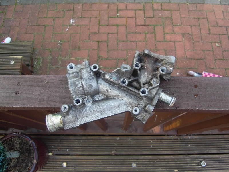

I intend on getting an alloy boss welded to this to fit an additional Omex coolant temperature sensor. It was fairly clean when I got it but a quick once over with some brick cleaner, turps and a stint in the dishwasher brought it up nicely. I might buy some Samco coolant hoses when I fit it....are they worth nearly £70 though?
I could have used my existing housing but I want a proper bleed screw to enable the system to be bled properly. With the existing coolant sensor stuck on the bleed screw hole it's not known how well the system is bled.
