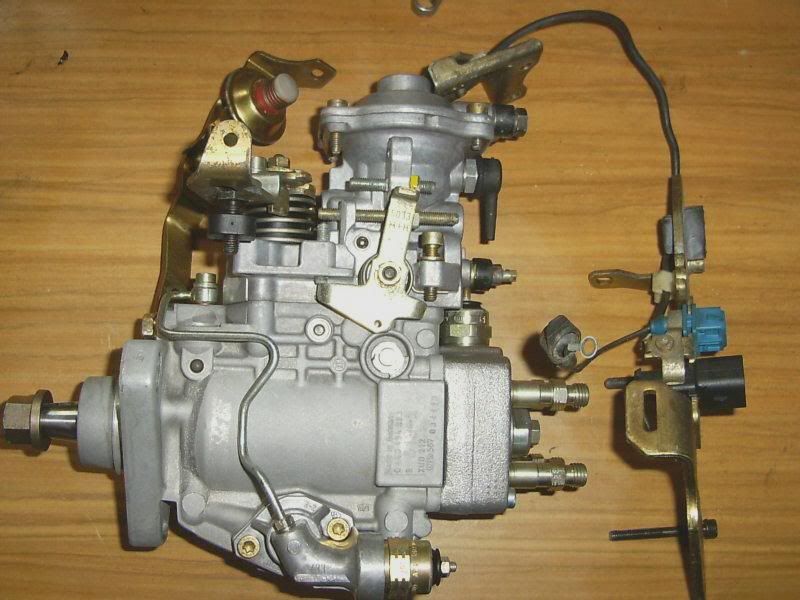

on the dw8 1.9 it has a lucas fuel pump and the stop solenoid has a anti theft plate around it you have to grind it off and its a nightmare on the car but not impossible as i have done one with a dremmle before here is a pic

Forgot to ask, how do i know if my pump is a lucas or bosch? Ive seen a DW8 engine spec and it says it could be either pump.

most come with lucas the lucas is the one in the pics above a bosch is the pic below
on a bosch the solenoid is exposed so its easy to get to bosch are very rare on dw8 in the 206 they put them on the 306 dw8 and a few berlingo vans

I had a look and found somebody has already cut the steel cover that hides the solenoid and it looks like a new wire has been added in for some reason. Thought it might be a bad connection so i took the nut of the solenoid and cleaned the contacting metal. This wire doesnt look original at all.
Think i will just replace the soldenoid. Do i need a special tool to take it out ?
