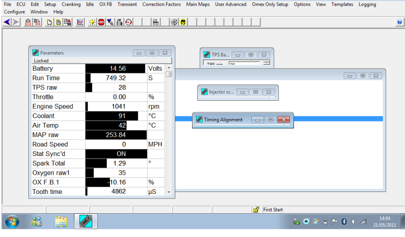

A bit more messing today. I hadn't switched the engine on since the fan had been rewired.
Fan works fine and is set to come on at 93 degrees and go off below 91 degrees. I have definately never heard the fan on at high speed before so I think it had corroded terminals on the high speed relay for a long time.
Will have to drive the car one day and see what it runs at when driving it hard. I don't think it ever went over 85 degrees though. Don't want the fan switching on when the car is moving. Shouldn't be a problem though.
I noticed the air temperature was looking a bit high...it got as high as 50 degrees...
Air temp sensor is sat right above the lower coolant hose. Is it picking up heat from it? Might be ok on the move but I might have to think about relocating it. Long term it won't be a problem as it will be mounted in the air filter backplate when the longer trumpets are fitted.

It could be picking up some heat soak from the coolant hose.
You got anything heat proof like a soldering mat you could use to shield the sensor area as a quick test?
PostPosted: Sat May 21, 2011 7:55 am Up
Yeah I could wrap it in something...
I think it's best to just move the sensor round the back of the air filter box or maybe even into the side of the lid. Maybe just moving it further down the airbox from where it is now will get it away from the hose. Will need to extend the wiring though.

There is a possibility that you are getting a heat reading from the hose, I take it that the air temp sensor is in the standard airbox at present. I have fitted mine between the two centre trumpets to get a good average intake reading. With the carbon airbox you have on your T/B s
I would say they would be ok but fit some heat reflective film on the hose side of your standard airbox to prevent heat soak. An experiment with kitchen foil always works before you invest in the real deal. However I think that on the road you wont be affected by the heat as much.

Ordered some more electrical bits and bobs while on holiday. They were fitted today and that meant the air temp sensor could be moved to the opposite side of the airbox behind the headlamp.
