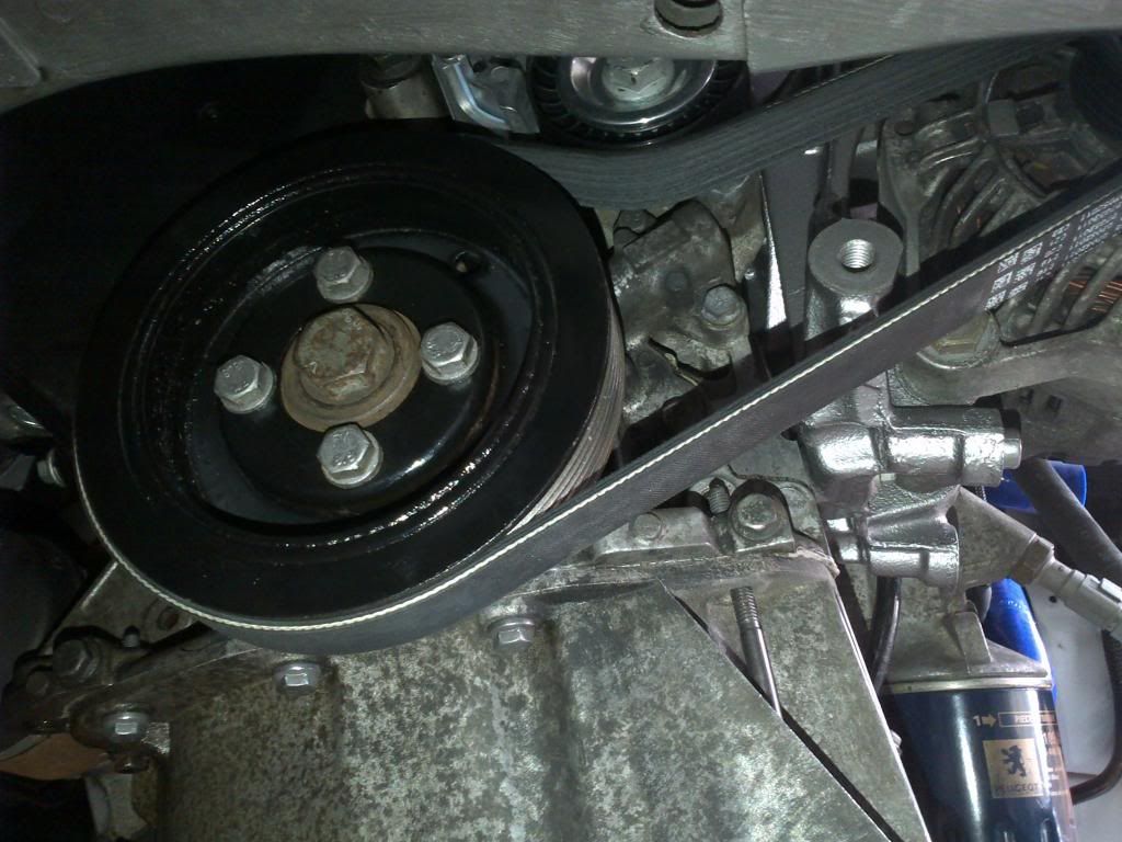

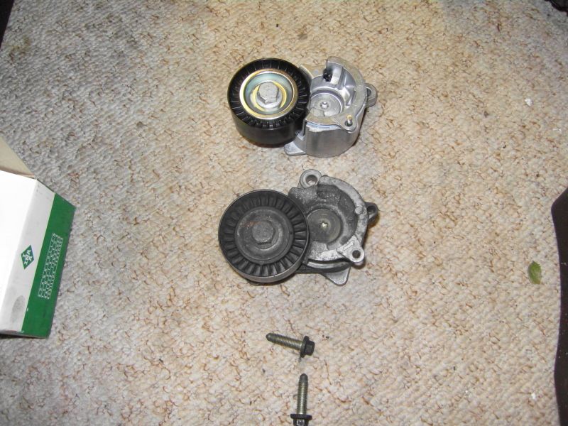

Bit more spending today. Decided I didn't like the play in the belt tensioner bearing. So I bought a new tensioner...of course it will be fitted with some new bolts too!

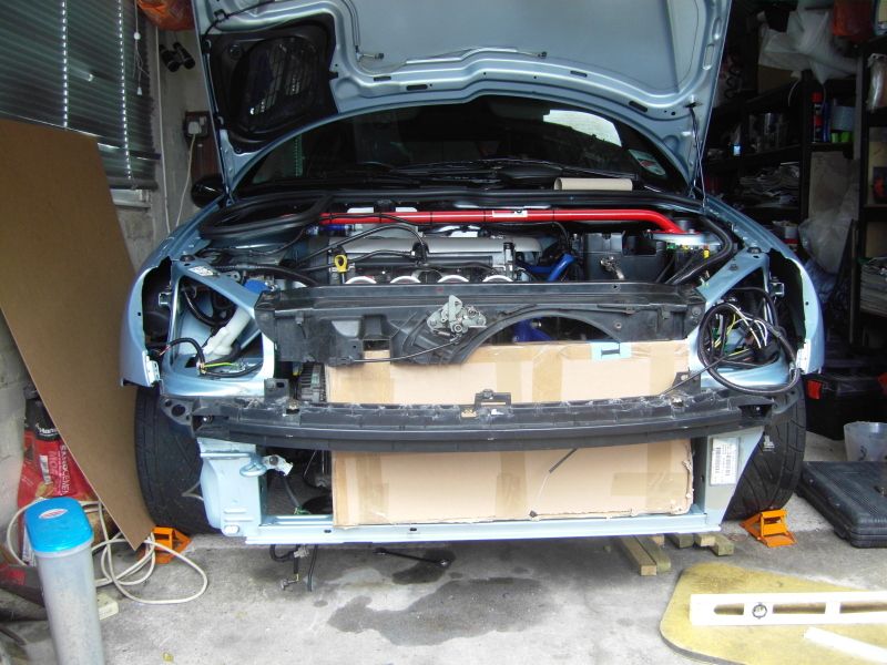

Decided to made a cardboard radiator today. It's not too good at holding water though. As soon as I know how deep Radtecs dual core radiators are I'm going to make a dummy out of hardboard or thin plywood.
Then I'll get all the measurements exactly as the final version will be and will probably trim the old rad housing a bit more. Once I have my wooden radiator it can then be fitted with all mounts in place to make sure it doesnt foul anything. I think I'll be able to re-use the original upper radiator mounts and hoses too.
I also need my new air filter before I trim any more off the remains of the slam panel. I just hope it's strong enough once it's trimmed.
Should be enough room at the front for one or two fans.

New bolts for the tensioner.

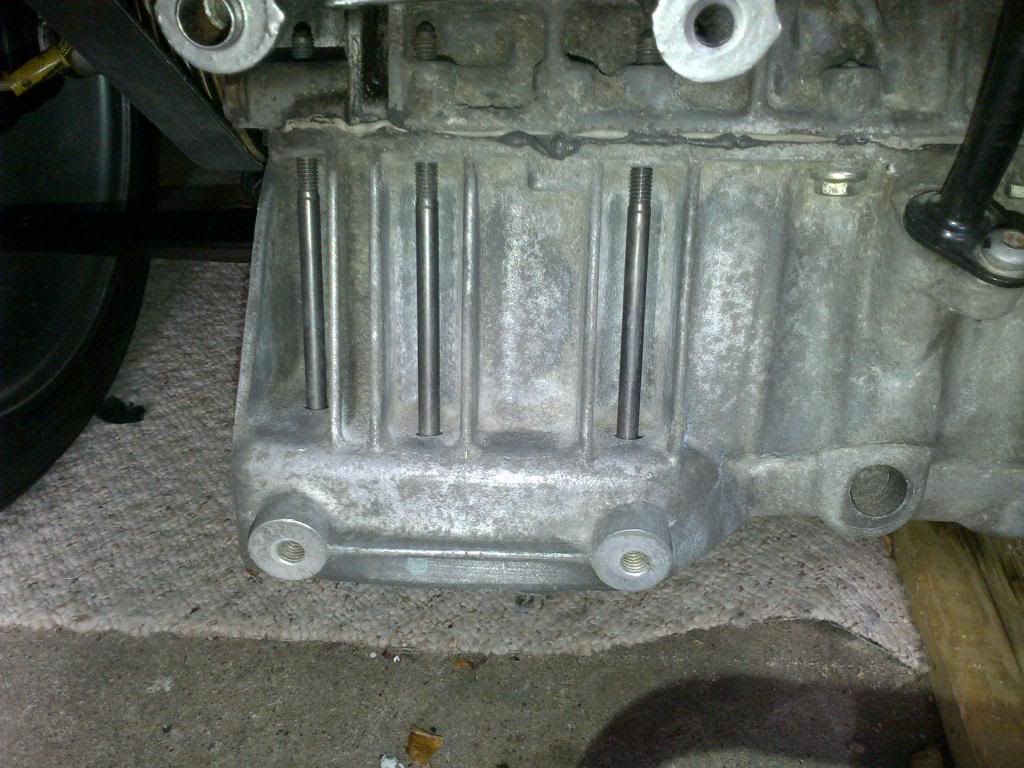

New bolts for the sump...
Old bolts...
New bolts...
All fitted back together...

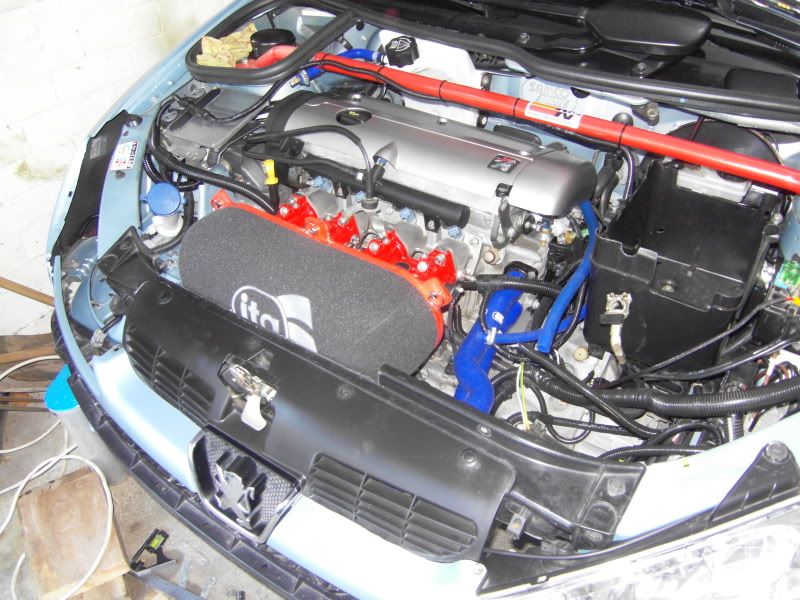

Filter has arrive today. Cut the back plate to fit. Just needs a Dremel to cut away the burrs from drilling it.
Next step is the Saxo PAS pump and then I'll know what space the radiator car fill.

Trimmed the remains of the radiator housing a bit today to fit round the air filter. Still needs another 5mm removing to give more room for the engine to move on its mounts.
I'm just keeping the slam panel to support the grille and provide a secure lock for the bonnet. I wouldnt think what's left is strong enough to secure the bonnet when driving.
