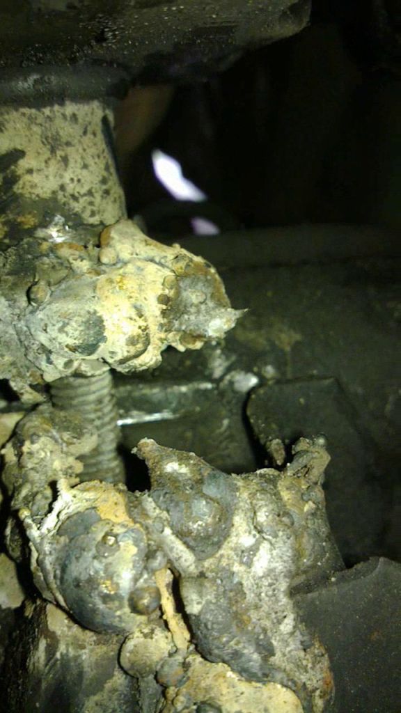

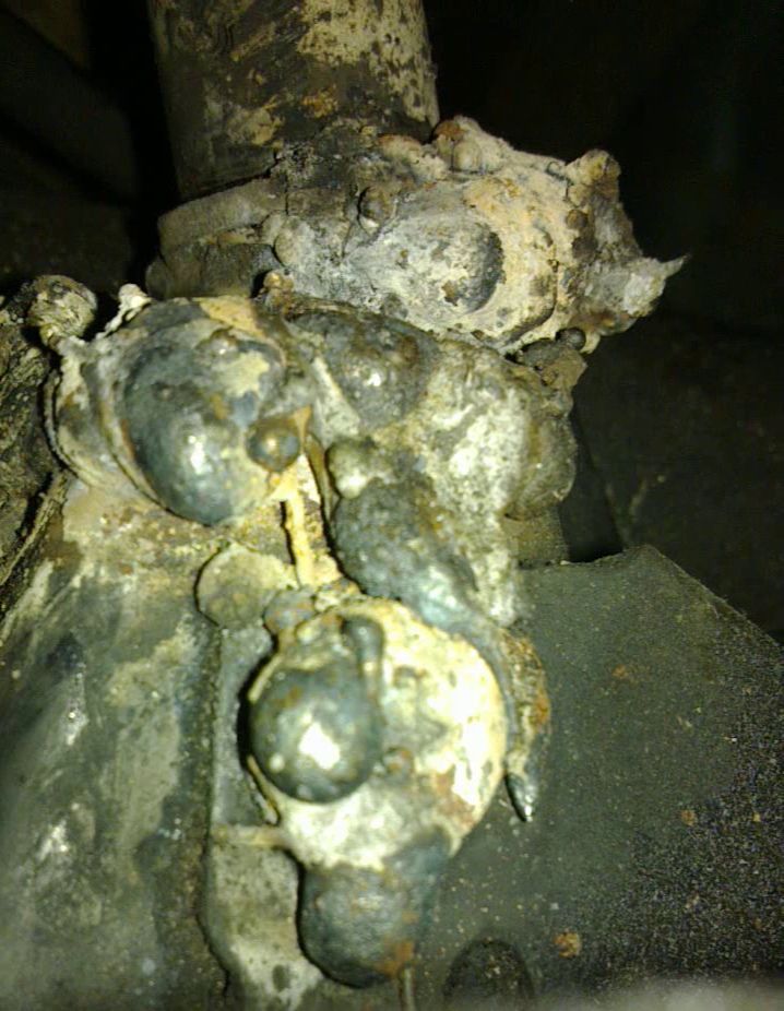

Sim
PostPosted: Sun Oct 21, 2012 11:05 am Up
Joined: Jun 20, 2012
Posts: 1199
Location: West Country
Hya!
Dived deeper today, and that's how it looks like above the sub-frame (when link is in place):
And when I put it out of place by hand:
Real gore!..
Hope some garage can do a decent job on this, if that can be called decent anymore Smile
Cheers chaps!
