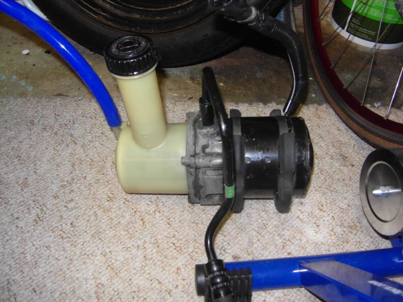

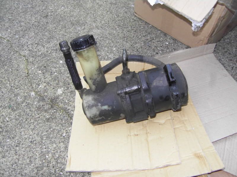

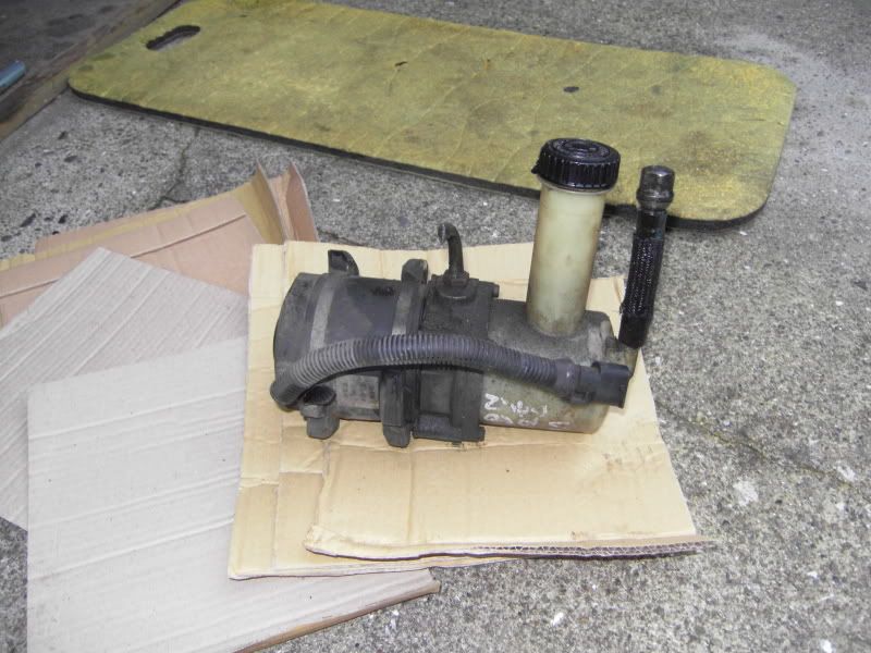

Steering pump arrived today. Needs a bracket to mount it and the cap is damaged so I need to soucre a new one. They don't seem to be available as a part on their own. If anybody knows where I can get one let me know.
Arrived a bit dirty...
A bit cleaner now. I also fitted the remains of the original 206 pressure hose from the old pump.

Same pump as mine mate, when you do the loom, fuse it before and after the relay as they draw a hi current. You'll need the bracket that should of come with it off a 106 as it's got rubber mounts to stop it vibrating.

Yes the clips round the pump have the rubber on it. Is there any difference between Saxo and 106 pumps and brackets? I think the Peugeot bracket might be slightly cheaper.
I notice the current draw when I tested it yesterday. To make sure it worked one thick cable and a thinner one direct to the battery resulted in the thin cable getting quite warm!
It also needs a new cap and I'm hoping the caps are the same as the cars with a seperate reservoir as you can but new caps for those types.
You got any clear pictures of your bracket? I'm thinking it might need to be attached partly to the original airbox braket for extra support at the side.

I haven't mate I'll get some at the weekend for you it's sort of at a L shape so fits in the corner by the old air box at the bottom of the metal work were the abs pump is sitting on think they used 10mm cable for the loom
