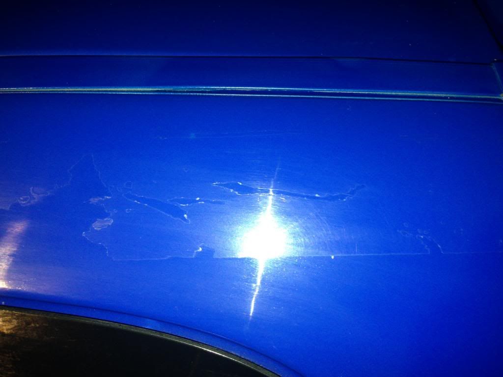

Hi, I recently put spoiler on my car with tiger seal. I used masking tape to hold it in place while it set. I half removed the tap and put it back on while it was raining just to check its hold. The next day when I took all the tape off it pealed some of the top protective coat way and now looks like this. Has anyone got a clue on how i can repair this without it costing a fortune.
Thanks.

That's the lacquer. You will need to get the panel relacquered.

yup, relaq the panel, would cost about 15quid in bodyshop if that, only problem is the laq needs 24 hours to dry so id wait until you dont need to car :/

What bodyshop are you using that will only charge £15 to re-lacquer a panel? Brush painting varnish on would probably give a better finish.
A good bodyshop will have a car in and out in a day for a paint job.
