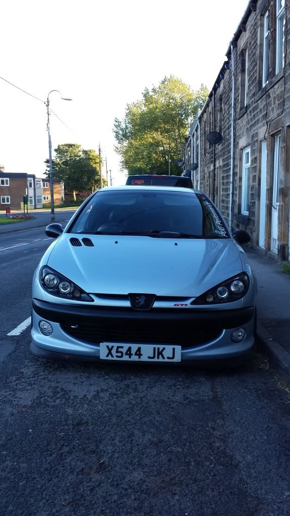

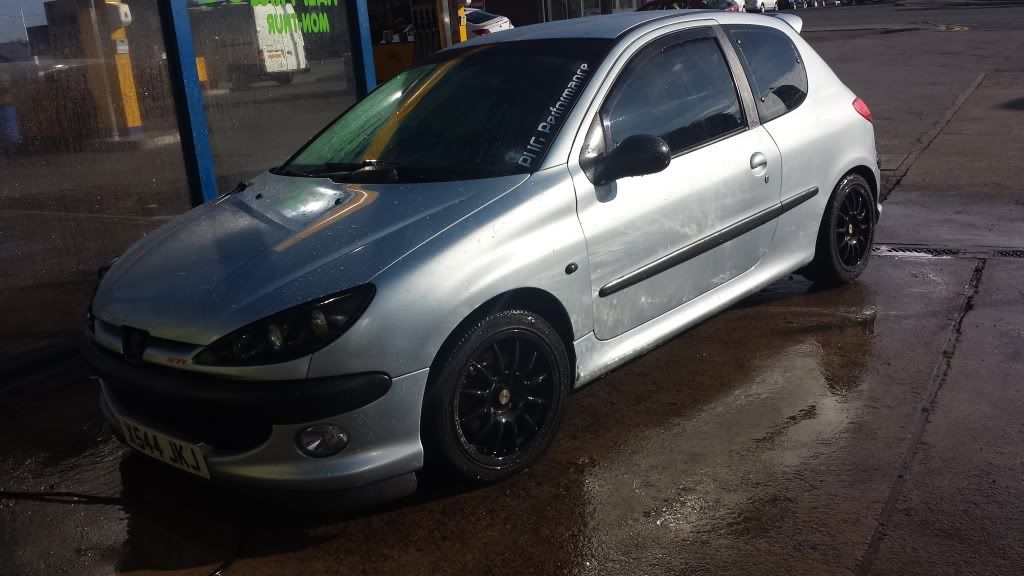

Gave to car a clean today and it came out very well. Found a few new parking dents of bellend opening their doors against my car what has really p**sed me ff! people have no respect for others Sad
