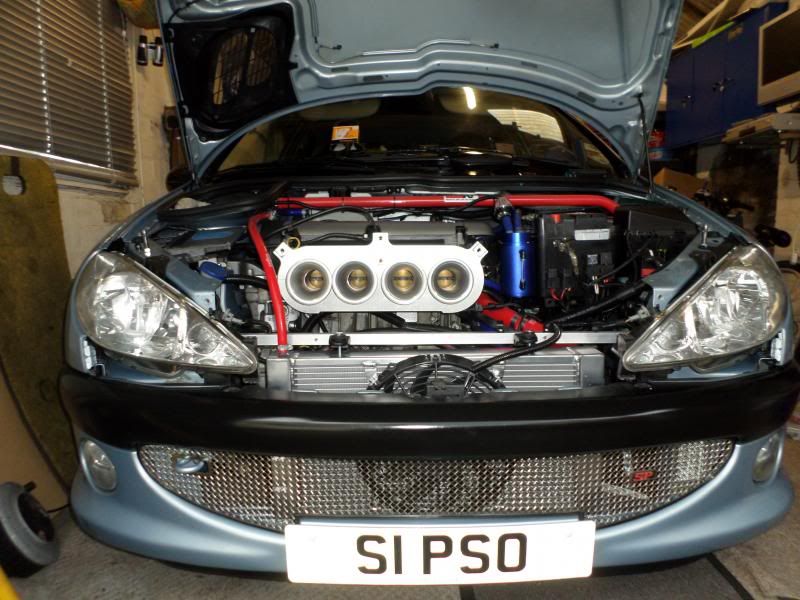

It was £500. I just hope its big enough. The fan is nowhere near as loud as the standard Peugeot fan so I just hope its adequate. Its hardly a car I plan to sit in traffic with anyway.
Much more of this radiator is exposed to airflow and its capacity is bigger so I'm confident. The standard radiator only has the fan area exposed.

It was expensive and I know other places will do them cheaper but Radtec have a good reputation for quality.
The original radiator has 1,017sq cm exposed to airflow.
The new radiator has 2,600sq cm exposed.
Old radiator capacity was 6,042 cm3
New radiator capacity is 9639 cm3
So it should be fine hopefully.

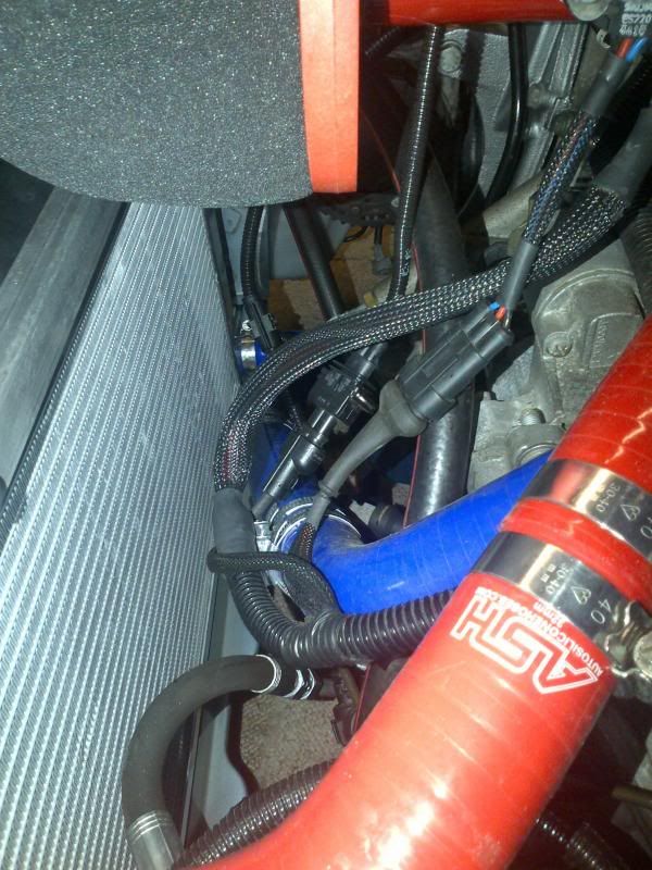

All plumbed in now. £50 of hoses. Then I just need to finish the wiring to the fan. The relay is in place so wont take too much effort.
The original standard GTi Samco hose was used at the bottom with a 20cm extension put in the middle. Clears all obstruction which is nice. Just need to support some of the wiring.

Bit more tidying up done today.
Fitted the alarm sensor which cost a whole £1 as the original on the bonnet catch wont fit anymore.
Fitted some P clips to the radiator support bar to secure the wiring in place.
Looks almost finished now. A couple of things to finish off then it's all done.

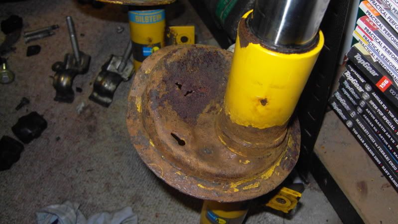

PostPosted: Sat Feb 01, 2014 1:54 am Up
usher wrote:
looks much neater all painted up, and how can you say your car will suffer corrosion its offencive lol
Did you ever see the previous Bilstein dampers? After 25k miles and seven years they did this! Must have been made from the cheapest steel ever. The rest of the car remained immaculate but these dampers became quite dangerous!
usher
PostPosted: Sat Feb 01, 2014 3:42 am Up
Joined: Jun 04, 2010
Posts: 1691
Location: northallerton
yeah i remember that, and there german made lol, did you put them in the bin
