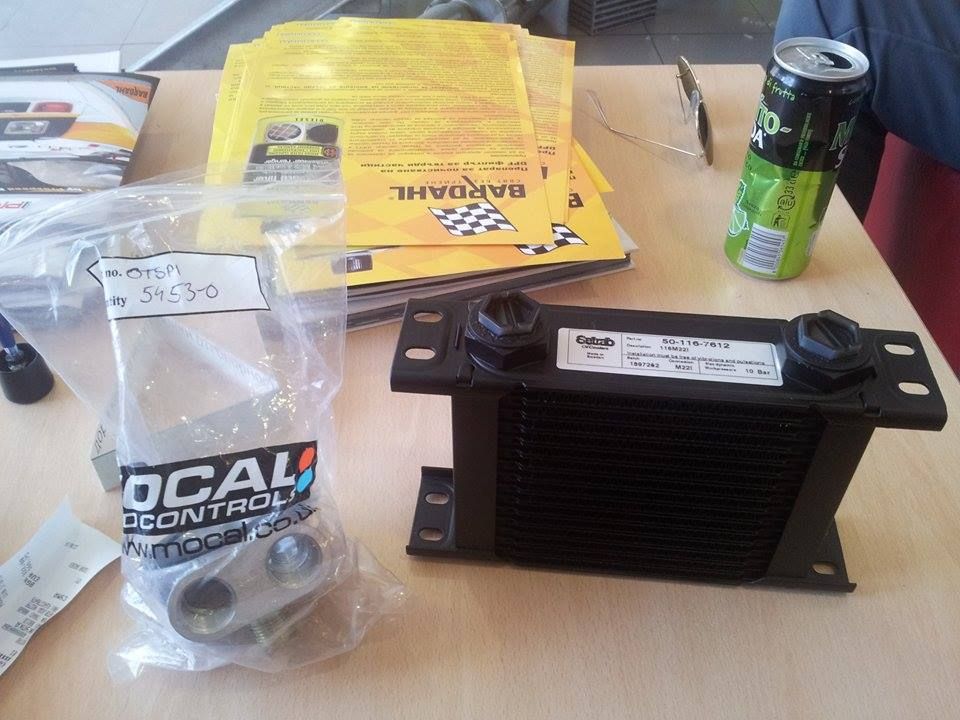

Update.
@America The DellOrto TB is from a V6 Alfa Romeo but I wouldn't suggest going that way as you will need to rework the whole mechanism of the butterfly. The car is performing brilliantly!! No issues whatsoever. I haven't done any timed accelerations yet, but I'll do when spring sets in and I've got semi-slicks on the car.
We are expecting a lot of snow here soon, so the car will be going into hibernation for the winter. There is a pretty long to-do list so I'll keep busy.
Some of the planned mods include:
- 406 V6 Brembos with ATE discs
- finally sorting out the intake
- mounting the oil cooler
- launch control activation
- semi-slicks
Bonus: A small 70-150km\h acceleration with very slow shifting Very Happy
vimeo.com/106585275
