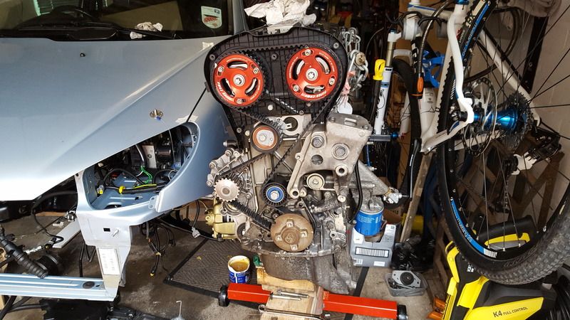

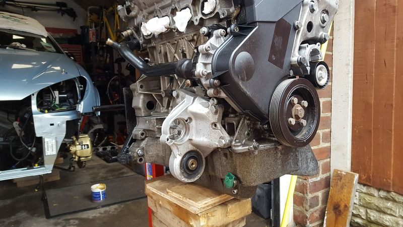

Engine is out now. I definitely need a bigger garage!

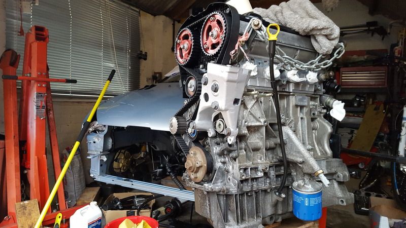

PostPosted: Sat Oct 29, 2016 5:11 pm Up
Finally got the engine on the stand today. Flywheel was removed the other day to enable the crank to be turned when it was on the stand. It has a slight oil leak but I'm not sure where it's coming from. I think there's one from the cam housing as there's a little puddle between the cams and on the thermostat housing. There's also one on the Cambelt end of the engine. Does anybody know what that core plug is covering on the head? Is it oil or water jacket?

PostPosted: Sat Oct 29, 2016 5:59 pm Up
Posts: 2724
I'd replace the crank oil seal as its out anyway.

PostPosted: Sat Oct 29, 2016 6:39 pm Up
I did think about that but I'm also thinking that 15 year old seal that's not leaking might be more likely to be a problem if it's disturbed and a new one fitted...if you get what I mean?

PostPosted: Sat Oct 29, 2016 8:16 pm Up
Posts: 2724
I understand what your saying, but when I changed my flywheel and clutch and put gearbox back on, my seal started leaking! All of again for a 2 minute job! Your call!

Steve206
PostPosted: Sun Oct 30, 2016 8:27 am Up
Posts: 2724
Is your leak coming from between the cam and the block? That's where mine was, just needed resealing.

PostPosted: Sun Oct 30, 2016 8:47 am Up
Posts: 11526
Pretty sure there is a known oil leak issue on these which will be an easy fix with the engine in its current state, ill find the details.
Also if it was mine, I would replace the crank seal with a new genuine part while I had the opportunity.
A 15 year old rubber seal will be getting very tired & near the end of its working life.
The seal is £24 from a Peugeot / Citroen main dealer parts department.

macj
PostPosted: Sun Oct 30, 2016 9:03 am Up
Posts: 3085
I can whip one out and see Ed, I have several blocks here Wink
