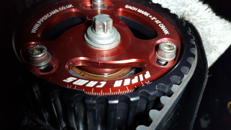

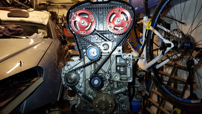

Bit more slow progress. Inlet cam housing has been off and resealed and a new cam seal was fitted. New water pump has been fitted too. A new Continental cambelt kit has now been fitted with new pulleys and tensioners. The sprung tensioner is a bit of a fiddle even when holding it in position with the allen key the pointer kept moving away from the correct position.
I'm not 100% how the tensioner works and the instructions state that it shouldn't be turned by a whole turn. I'm not sure if I have turned it completely or not so I think I'll spend the £38 from the Peugeot dealer and buy another one just in case! It looks ok just now, belt seems tensioned enough but best try again!

I remember doing my belt and found the tensioner a fiddle to work out. What did you use to reseal cams?

I used loctite 5980.

I am still experimenting with the solid tensioner from an XU engine, apparently it stops the belt whip at high RPM. I just haven't got the right belt length sorted yet
PostPosted: Sat Nov 19, 2016 10:54 am Up
I did think about how a solid tensioner would work and how it fits. I've got a tensioner from Peugeot now. Bit expensive and even the bolt was £6! I put the original tensioner back on the other night and we got the position correct first time.
Ordered a flywheel from Pug1off which are made by TTV in the UK. When that's on and the cam bolts are threadlocked in place the engine will be ready to go back in.
