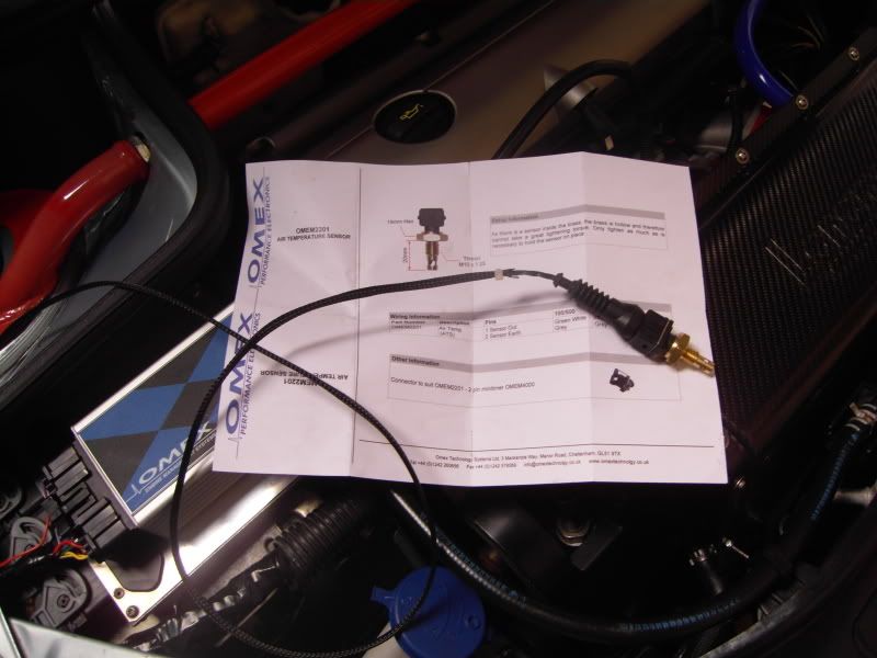

Got the air temperature sensor yesterday from Ecosse.
I just have to decide where to fit it. I'd like to fit it in the side of the airbox just near the PAS pump because it would need really short wiring to the ECU...
...but Ecosse have wisely advised me to install it downstream of the breather pipe, I guess to stop it oiling up. So I think the best place might be inside the standard air filter box under the air filter. It's a bit further downstream than I want but it's the ideal place where there is plenty of space and a flat surface to drill in t.

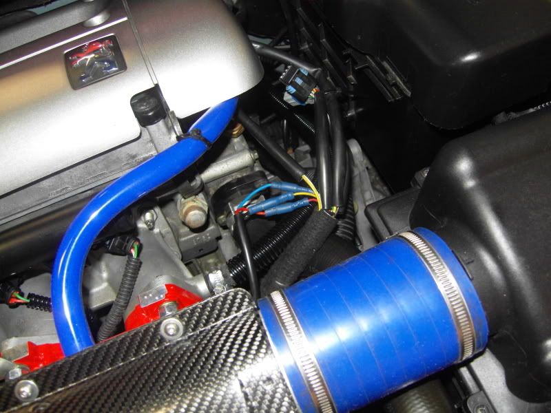

Before I fit it though I want to order some wiring bits such as the braiding I've fitted to the temperature sensor wiring because I want to replace these connections that go to the throttle position sensor. They are the sort of thing I'd use to wire a stereo with.
They're not waterproof and while the car isn't going to be used in wet weather, I'm going to fit a 3 way Superseal connector like all other engine bay connections use. No I won't be removing the TPS sensor to fit it as this will ruin the settings in the map.

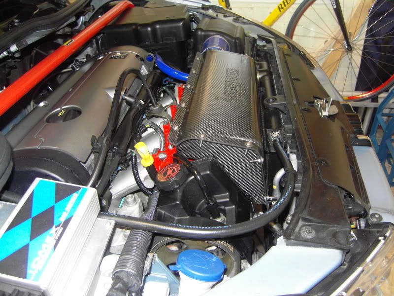

A quick look up at the bottom of the throttle bodies shows how tight it is between the airbox and radiator. I also fitted some cables ties to the bottom of the airbox to hold the lid in place. The bolts used elsewhere are impossible to fit without removing the radiator.
