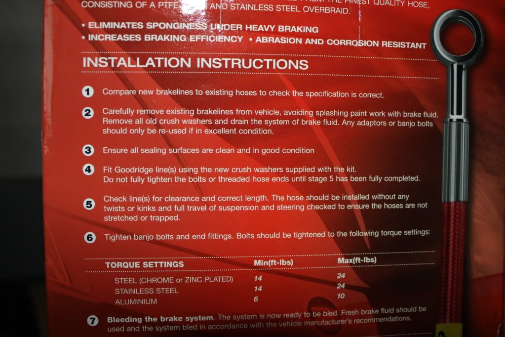

There's a fitting guide [installation instructions] on the back of the pack (assuming it's a genuine Goodridge box) - although it doesn't give a rundown of tools required, etc.

Hmm. Dave threw the pack away when there was nothing inside it, without thinking to look at the back.
Whoopsie!
So any idea about a guide, or maybe a scan of the back of the pack?

yeah, I'll scan it - brb

Cheers mate. Not exactly rocket science then...
But heh so no explanation of the random 2 other differing length hoses which is a bit dissapointing. I also am fairly sure there weren't any washers with the kit. Guess I can get some though.

I suspect the rear hoses are generic, due to unequal lengths. I am sure that when Kyle did my brake hoses they too were unequal.
Don't worry about it Laughing
No, mine didn't have washers either [nor the set I've got for the 205]
