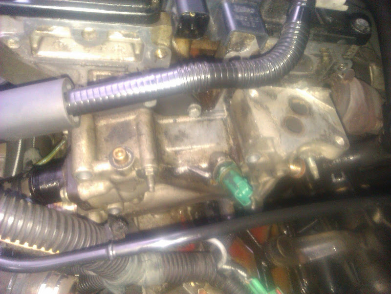

just a quick update - i have taken 5 bolts out the thermostat housing unit and this thing really does not want to play ball and come out.. should it really be this hard to remove ?
just grabbing a picture...
206 138 gti \'99 no mods
PostPosted: Mon Jan 03, 2011 7:00 am Up
Posts: 7047
The two threaded rods that normally have nuts on them also need removing. Just get two nuts together or some mole grips on the ends to unscrew them.
Just give it a quick tug sideways (also hold the metal pipe under the manifold) to pull the pipe out of the water pump. You won't get the pipe out of the thermostat housing because it's held in with two seals so is rather stiff.

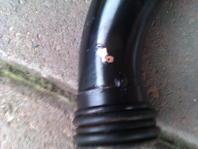

well found the culprit of the coolant loss..
now need to find somewhere open to get the pipe and seals.. thanks for your help guys.. nearly there.
PostPosted: Mon Jan 03, 2011 10:24 am Up
Posts: 7047
Is it worth going to a scrappy? New pipe is about £30 I think. Seals cost peanuts.
