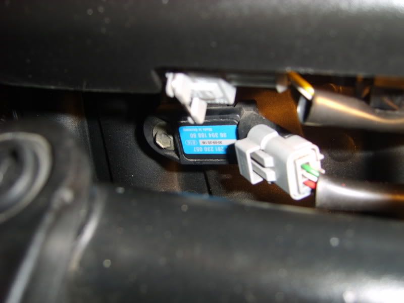

Map sensor is on the front of the inlet. Sounds like you found it because all the others are hidden under the plastic bit on the TB.
MAP sensor
TB with idle control valve missing.

Yeah thas it. I saw a picture online of Pug MAP having a yellow resistor looking thing in the hole, but it was too similar for it not to be right. Idle control valve is a check too. Cleaned the opening as well as the rubber pusher and shaft.
I removed the unit on the right of the TB which is still attached on you second picture but Had no idea what is was so put it back Laughing
And after a little bit of time I finally removed the 5mm of carbon deposits on the plenum. I know this won't make a differnace as it doesn't effect the opening. But it made me feel better.
Thanks for the pictures, it's set my mind at rest that i've got the right bits.

In the picture above am i right in thinking that grey plug on the bottom of the TB is the air temp sensor?
I cleaned this area and the problem improved for a few days. for 15quid it's has got to be worth a shot. One is on the way just in case.
PostPosted: Mon Mar 07, 2011 7:18 am Up
The grey plug on the front of the TB is the air temp sensor. The grey one on the manifold is the map sensor.
