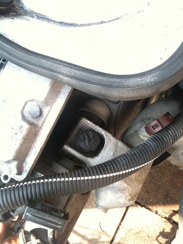

how does it come off, my old cars one was just a nut and haynes only shows a nut too, but this one has a rubber thing on top Confused
there is a nut under the rubber thing but cant get spanner on it Evil or Very Mad
i have tried pulling rubber thing off but no joy Sad

that needs a 32mm socket or similar

get the rubber bit off the top . l mine was in two bits when i removed it lol i thinks its like a 16 or 17mm but cant really remember , i just airguned it off ( as it was f****d) then screwdriver on the side of hte metal mount' hit it with a hammer so that its un screws .. take it off screw the new one on handtight . put the rest of the mounts back on and tight up with a snap bar .. thats how i done mine at college with my teacher

its just a 32mm nut with a bit of rubber on so if you push down on a 33mm socket it will go on and undo it.
feels like its gonna slip/round off the nut but it will grip it enough to undo it.
that nut goes from the rubber to the base which is the threaded nut Smile

nice one, i got a 32mm that i use for the driveshafts and rear hubs so will smack that on Laughing

Tried what u said but it just spins Confused

That rubber thing has a M10 threaded metal insert inside it, you really need to grip it tightly to get it to start to undo.
You might end up destroying it on removal.

Thanks I ripped the top off it trying lol,
Will get some mole grips on it and try again Smile

You removing the complete engine mount?
Hope you have the special Peugeot tool Wink
Hammer & decent punch works if your carefull with your aim Cool

Rubber thing isnt fitted on all 206's, just some of them Wink

Air gun it! If your removing it then dont matter if you reck it lol i done it at college air gun the nut off , hammer and screwdriver bang to unscrew it and screw the new one on

out of curiosity im getting quote a bit of a rattle when starting the car up and this engine mount has a gap either side of it between there the bolt is and the rubber things on either side (buffers?), would that cause a loud rattling or is there supposed to be about a 5mm gap either side? because that's how it is on mine atm
