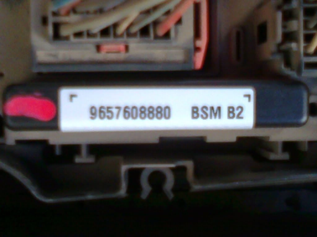

**Update 19-4-2011-The problem is solved and the foglights are working now,the solution for it was by replacing my current fuse box that is located in the engine bay with a new one,I had the (BSM B2),and I replaced it with ( BSM B3),and everything worked great,it's like magic..lol,here is some pic of the fuse boxs:
This is my Old fuse box:

Thank you for your help,and a Special thanx to (HDiMan) because he gave me the thought of replacing the fuse box :).Finallyyyyy
