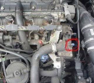

if you mean this
its one of 2 bleed points , its basicly just a dust cap so you could take one off a wheel and put it in its place to see if it stops the leak

Thats exactly the one.
If it is a bleed point and its spraying out would I be right in assuming its because there is to much pressure or can it literally just be a faulty valve?
No other signs or faults, engine temperature was not unusually high either.
PostPosted: Thu Jan 31, 2013 3:33 pm Up
could just be leaking
PostPosted: Thu Jan 31, 2013 4:05 pm Up
fix it asap so u don't damage the engine with no coolant run inside.this is the thermostat housing,and it got bleeding point,so if it's cracker where the blue cap fits,you will have to replace it.

probably not, but now I know it can be taken off without damaging anything it will allow me to look for the cause and in turn a solution.

While changing the dust cap would not quite have fixed it, it was not far off.
The rubber mounts from the plastic engine cover had broke causing movement. It had hit the dust cap and caused a small crack. Could have fixed it with super glue but I went and got a replacement thermostat cover to be safe.
