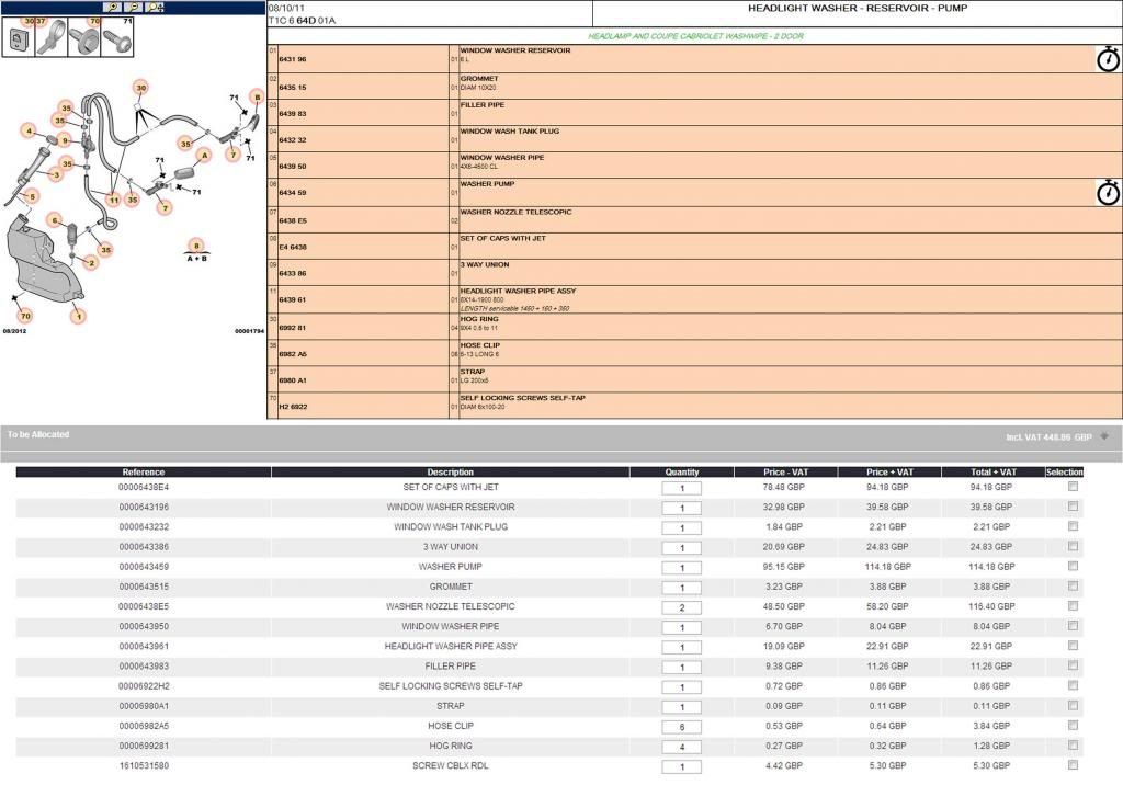

PostPosted: Tue Mar 26, 2013 5:11 pm Reply with quote Up
Posts: 11530
gtijames22 wrote:
seriously, can u link the parts so i can have a look, then maybe i can improvise with cheaper bits
Use Peugeot Service box
public.servicebox.peug...Parametres
You will need to make up your own FREE account to use it.

For anyone who want a bit of butt clenching... £448.86 inc VAT for the complete setup.
