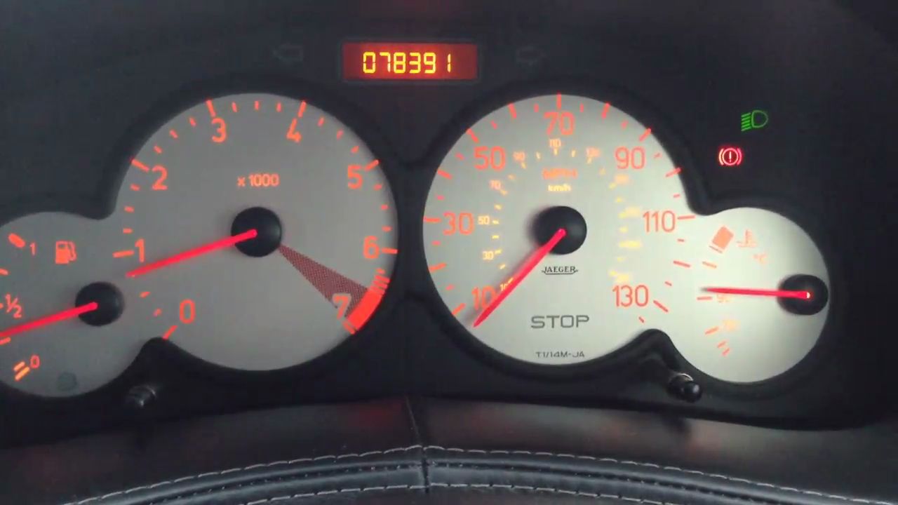

I did a BSI reboot. Not sure how it can be the radio.
It seems to happen only under these conditions:
Car at running temp.
Car just been driven hard (overtake or accelerate hard)
Coming to a stop
Clutch down feathering brake
The oil light flashes for a second so fast you can miss it. Sometimes the stop light will flash. The car beeps once
It can also happen with the beep but no light. This will happen once or twice on a 200 mile journey.
The oil level is fine on dash and dipstick. No oil leaks.
I am about to purchase an oem oil filter and an oil pressure switch.
If this does not fix it I will next oil change remove the sump and change the oil pump.
Other than this the car mpg is better than expected. It starts first time every time. Temp as expected. Car idles and accelerates great. Engine smooth and quite.

Well it looks like the garage may have found the fault while doing my headgasket cambelt etc. I will know more when I get the car back. If i do not get the fault again happy days Smile
I mentioned the fault to them and asked for the oil pressure sensor to be replaced. When they came to replace the oil filter, they found that a plate that activates the valve was missing.
So they have ordered and will fit this before I get the car back. They believe it is what was causing the issue as the spring would not be seated correctly.
I will update and move this to the solved section if I do not get the fault in the next couple of weeks.

So the car did the same old beep flash of the stop and oil light as the revs dropped below 800ish coming to a stop.
I have been looking on google and other forums and with everything I have already changed, I am now thinking it is the oil pump. Even ECP states an oil pump on the way out is difficult to diagnose but could result in flashing oil lights.
The mot Is due in sept / oct. I will probably have the pump replaced then......

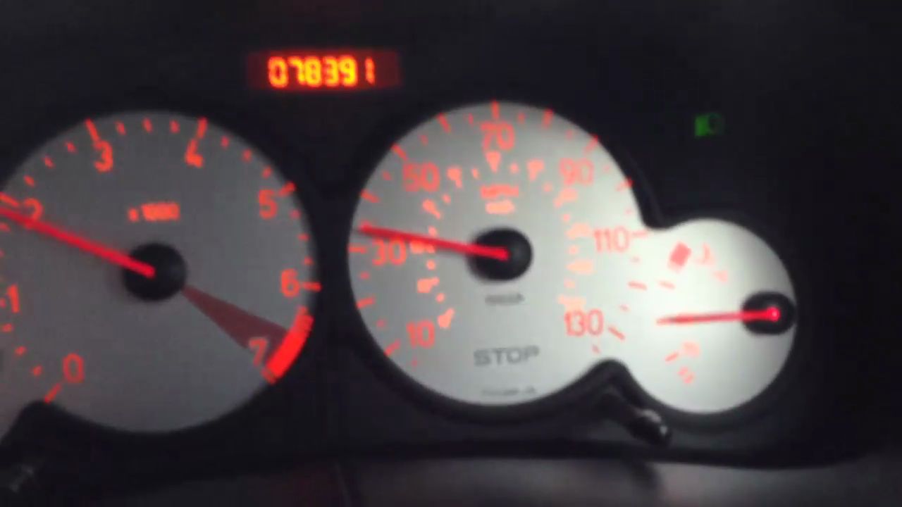

Videos of the issue:
