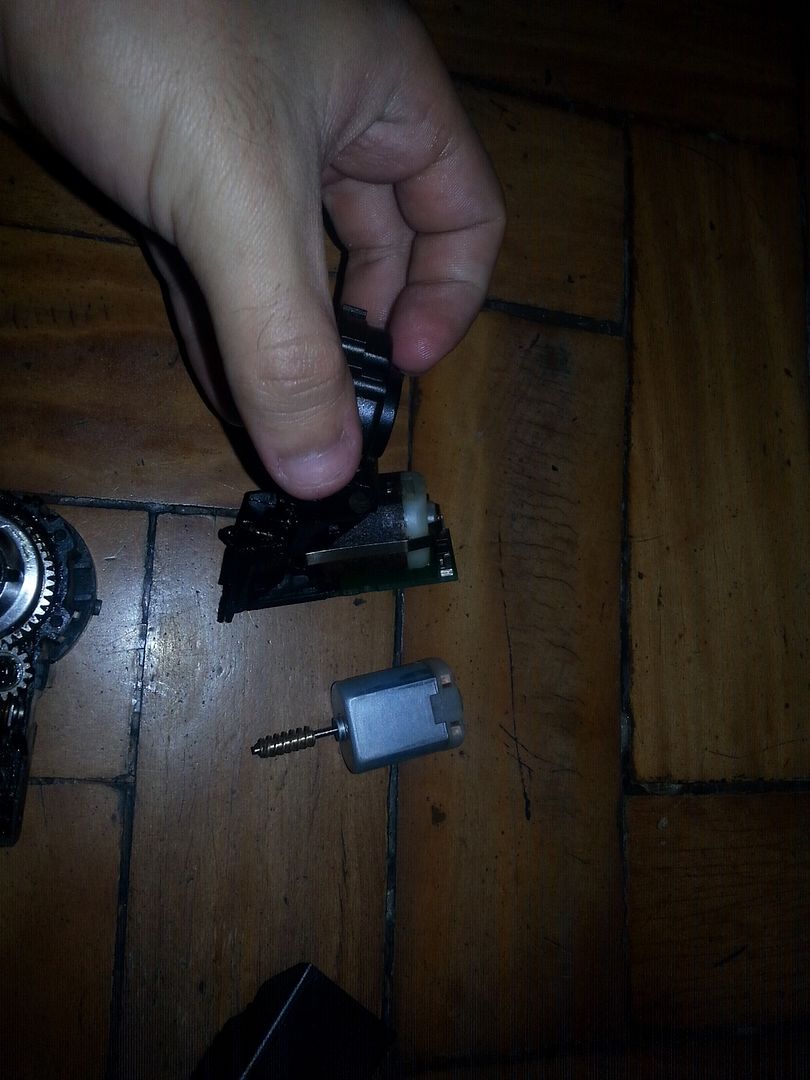

Good morning guys.
I'm just a new user from Brazil and in order to not create a new topic I'm looking for a little help!
One of the 2 rearviews is not folding. So I dismounted all things and the little engine from "Mabuchi" was rusted just like the friend said. I fixed it, assembled everything together and the little engine doesn't have "power" to fold. I also bought one similar and again it's not folding when in charge. In my hand without any charge it works perfectly but when I assembly it, it doesn't work. I'm new to the forum so I don't know how to post pics or videos.
Does anyone pass thru this situation?
Thanks in advance guys, great forum!

I figured out how to post pictures Very Happy

I've got a lazy drivers side one and acquired a stuck spare that I was going to take apart and investigate to fix, then do a 'how to' if I can work it all out. I think Mr BSI is well versed with these little blighters! And with what he's said and the pictures you've added it is already very informative.
Is there anything else to it or that I should know?
