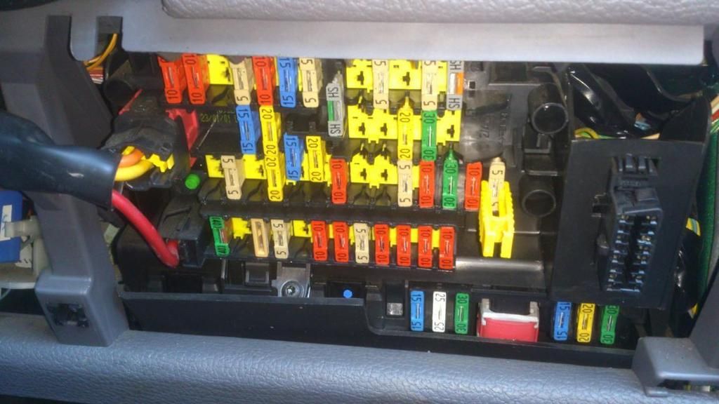

Hi mate. Thanks for that It is a pre plex. My bsI is held in by a torx screw and a clip you push in to drop it down then there is a fuse box above that. I have not replaced the fuse box is that hard to take out. I'll see if I can get some pics

[img]http://
[/img]
