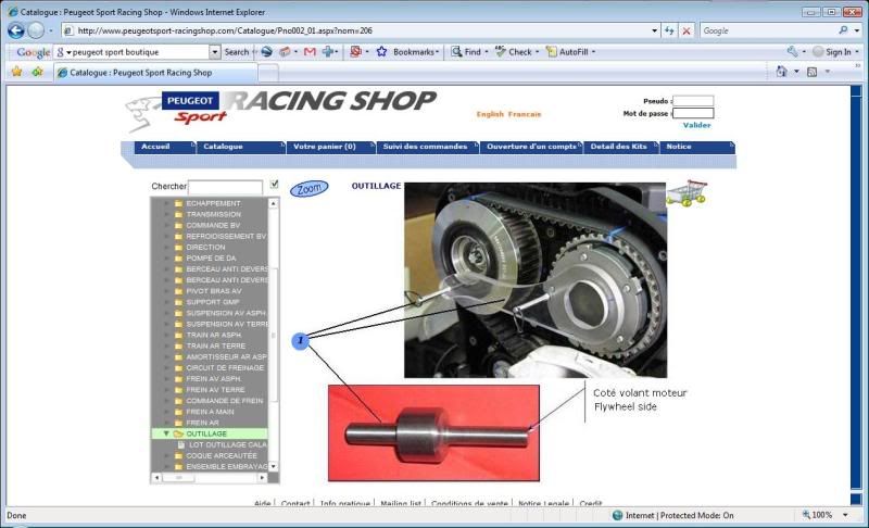

Did you use all the correct locking tools when you replaced the cambelt?
See page 3 of this thread.
www.206info.co.uk/Foru...tml#265073

Just out of interest how did you lock the inlet cam (or more accurately the inlet pulley)?
PostPosted: Fri Dec 31, 2010 5:43 am Up
danjames wrote:
you don't need speacial tools mate jus somthing good like allen keys to pin it with, im borrowing my freinds coil tomoz to test an see if thats the problem
FAAAAAIIIIL Rolling Eyes
they make the special pins for a reason why do so many people think they are not needed we spend thousands of pounds on timing kits at work so the job can be done properly there is a reason for that
engines like the tu 8 valve you can get away with it engines like the 180 with floating crank pulleys and vvt you are asking for a disaster
look at what edward has said it sounds like thats whats causing the problem best off taking it to a dealer and getting them to sort it properly lukcy you havnt done more damage to be honest
