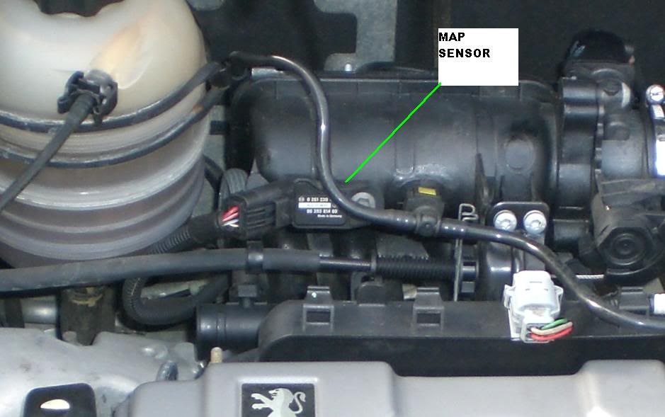

Where is the map sensor located please? Smile the only picture i could find that was half decent was this one lol (sorry)

Is the map sensor underneath on that tb bit? like before it enters the butterfly valve bit?
