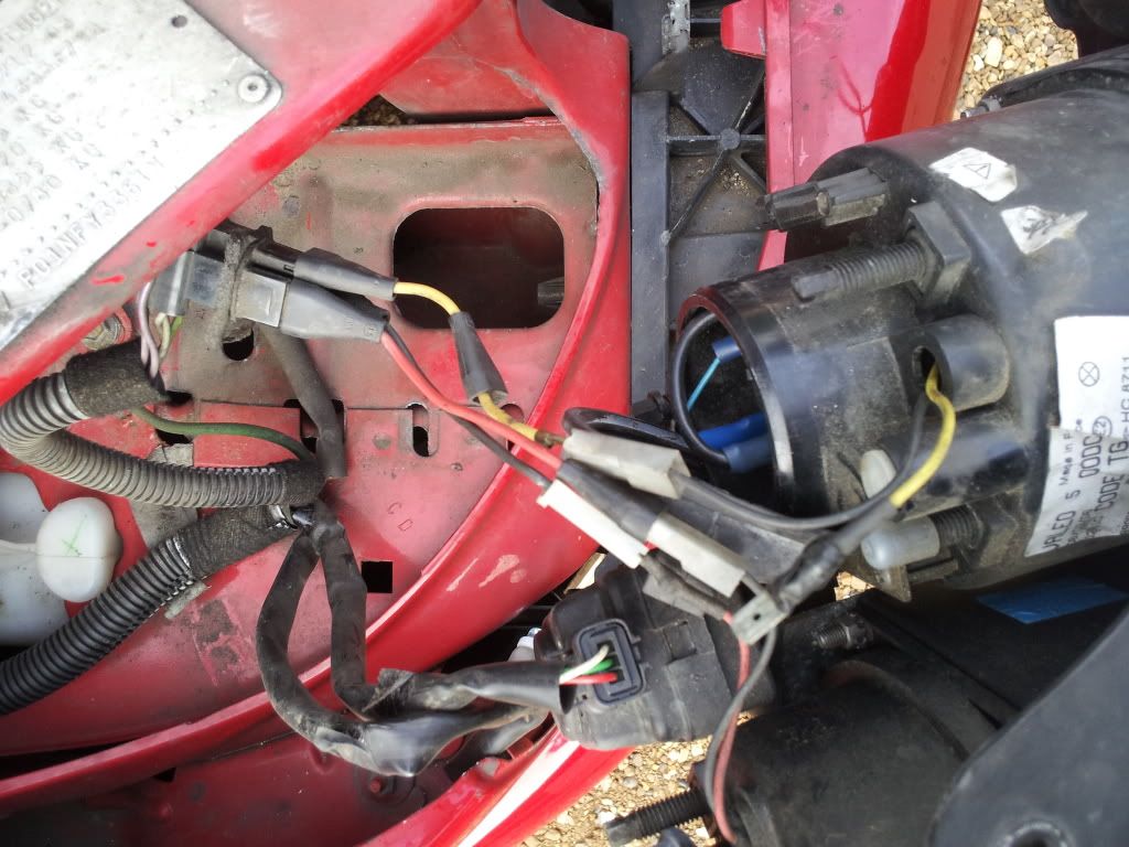

I just finished painting the plastics of the morettes, went to fit them and i cant get the dipped beam to work on the offside light. The other lights work fine but the dipped projector light just wont work, i tried different bulbs but nothing....
Here is a picture of the back of the lights. As you can se there are one black and one blue wire going into the bulb and then a black and yellow cables that come out and go into the main 3 pin plug. However, the yellow wire doesnt go anywhere, i tried connecting it with the black wire but still nothing, any ideas?

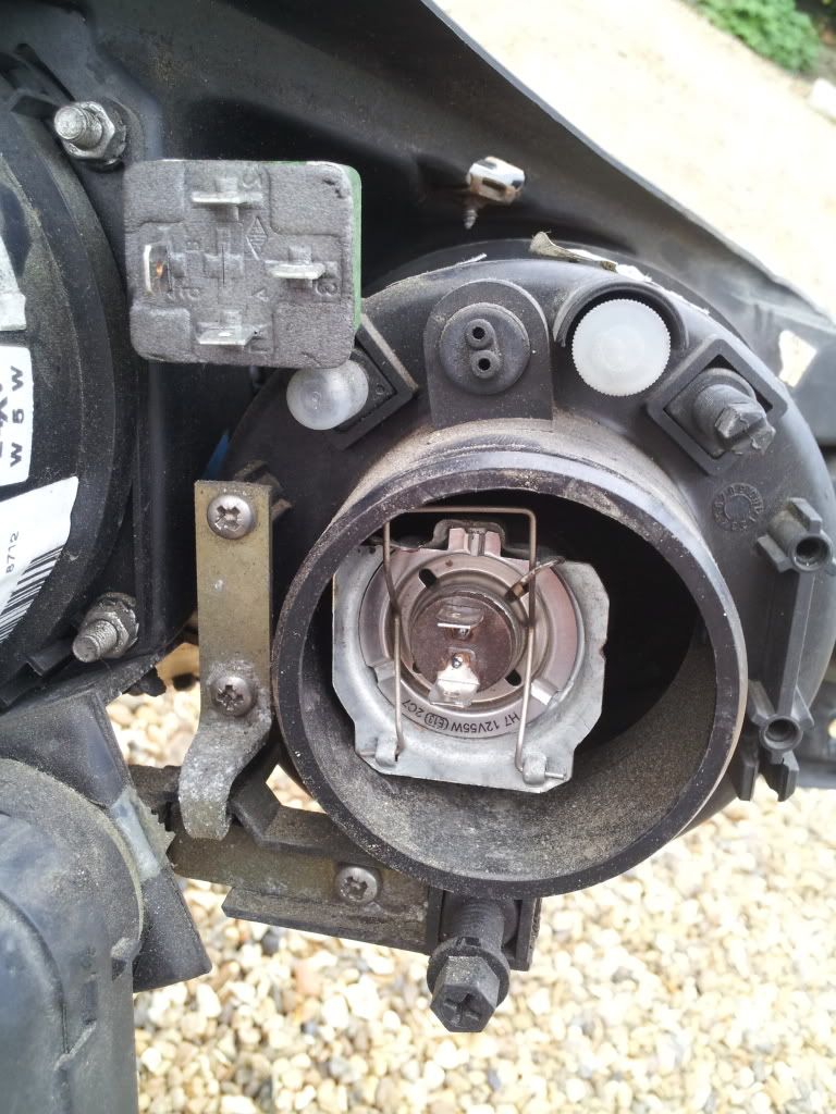

there doesnt seem to be anything to clip into the bulb on the dipped beam.... why is this?

Wiring looks a f*****g mess Shocked

yellow earth wire needs some extra wiring on it and connected to earth point.
as above, dipped beam missing wire from 3 peice connector/whole harness missing with relay/fuse.

All you have to make sure is that both earths connect to the earth feed (one of the spades on the H4 plug) and that each light (dipped and main) connect to the correct spade on the H4 plug, connect some spades to the bulb missing the connectors.
Pretty simple really
Unless you want to wire in that relay attatched to the back of one of the lights, then thats a whole new ball game Wink

missing wiring on the nearside light and then earth offside light. earthing point can be anywhere on the chassis.
