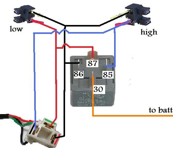

I know it can seem confusing, but forget about all the H4/H7 stuff. Your car is H4 but the lights are no longer H4 or H7 because someone has cut the connectors off, they are just H-Nothing at the moment lol.
The black triangle plug from your car supplies 3 pins,
Dipped+
Main+
Earth-
Just make sure each bulb has two wires comming from it, and connect the negative of both bulbs to earth, Then the positive feed from each bulb to the correct feed from the plug, then your good to go.

dunno if this is any help to you, just remove relay out of the circuit if not using one........
the h7 plugs that connect to lights can be found at most car shops so i would think halfords would have them.

Oh my mistake, When I wrote that I was thinking all morettes used H1 bulbs and had H4 or H7 plugs (although now I think about it im sure I was thinking about angel eyes).
That diagram northants posted is perfect, just follow that and remove the relay if you dont want/cant work out how to put it in.
