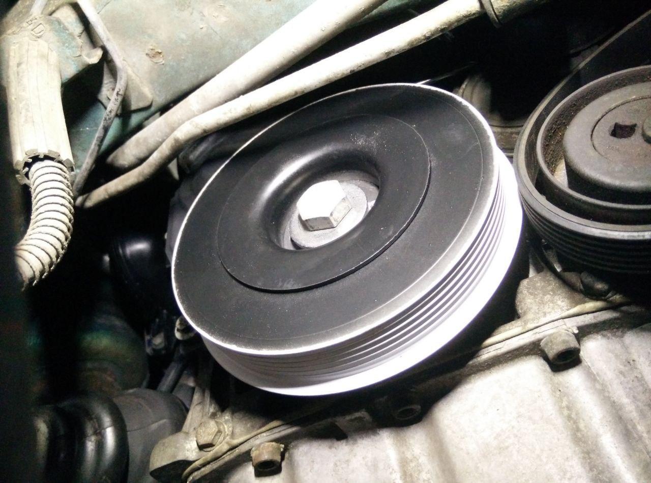

In autumn 2019 pulled Jude out of misery by washing away autumn leaves (of 2018), and started inspecting where the dreaded engine knock is coming from. Would this be the demise of the HDi?
And as always, rummaging through the forums I found gazza's reply about red dust prevalent near the crank pulley (aka harmonic balancer).
Sump had a good deposit of such dust, yet not only near the pulley: the insides of each of the front alloys were covered in such dust, which was clearly from the brakes.
The knock was heard from the drive belt side of the engine when on ground, but actually was louder near the flywheel when listening with the car up in the air (suppose it resonates throughout the crankshaft)...
Inconclusive yet I went ahead and replaced the balancer nevertheless (Corteco brand £57 from fleabay)
And whaddayaknow the knock was gone! So an indirect thanks to gazza82 for the pointer

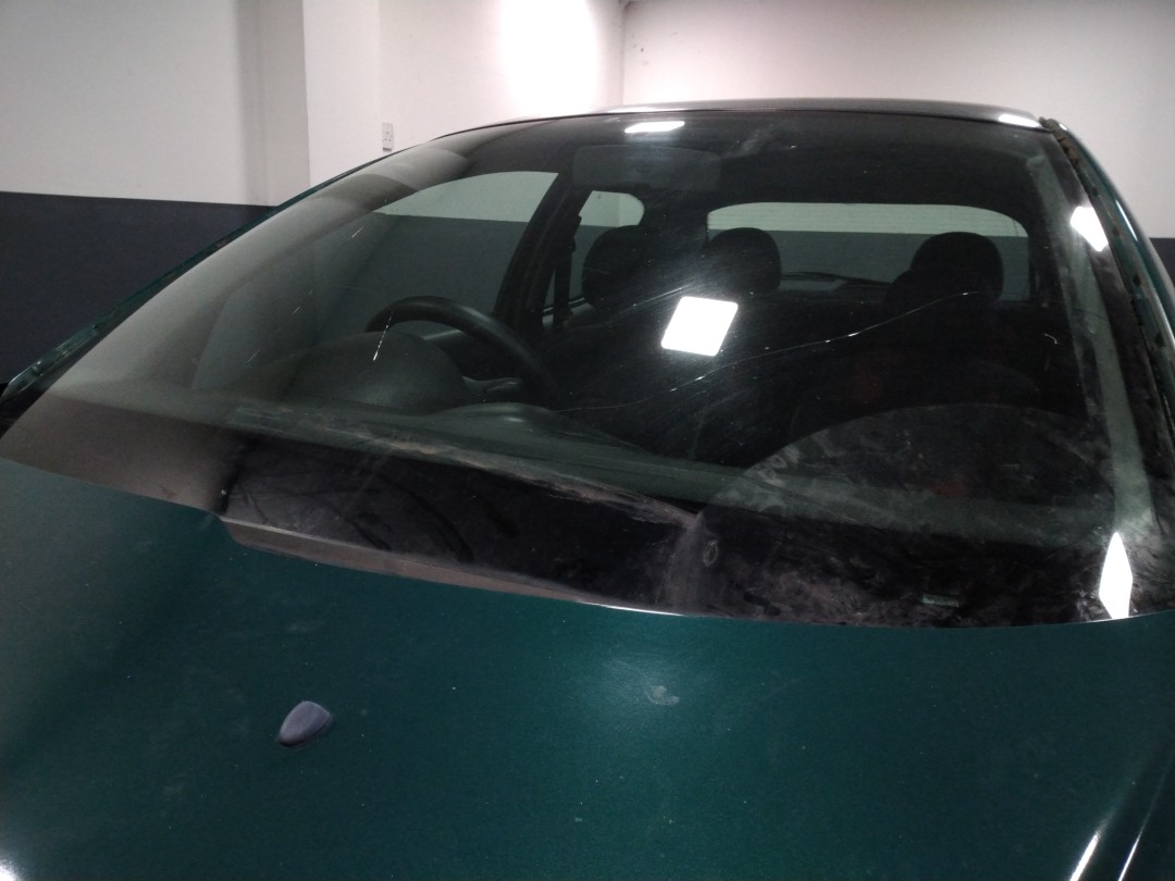

De-wipering the front was just in prep for a windshield replacement (in case you were wondering), because someway somehow the screen had cracked (from inside!?) overnight, while my mate had the car... Why nothing goes wrong when I drive (well, other things do)
Decided to go with a grey top-tint to match the overall spirit of the car
Treated immediately with the Gtechniq kit, will see how that fares

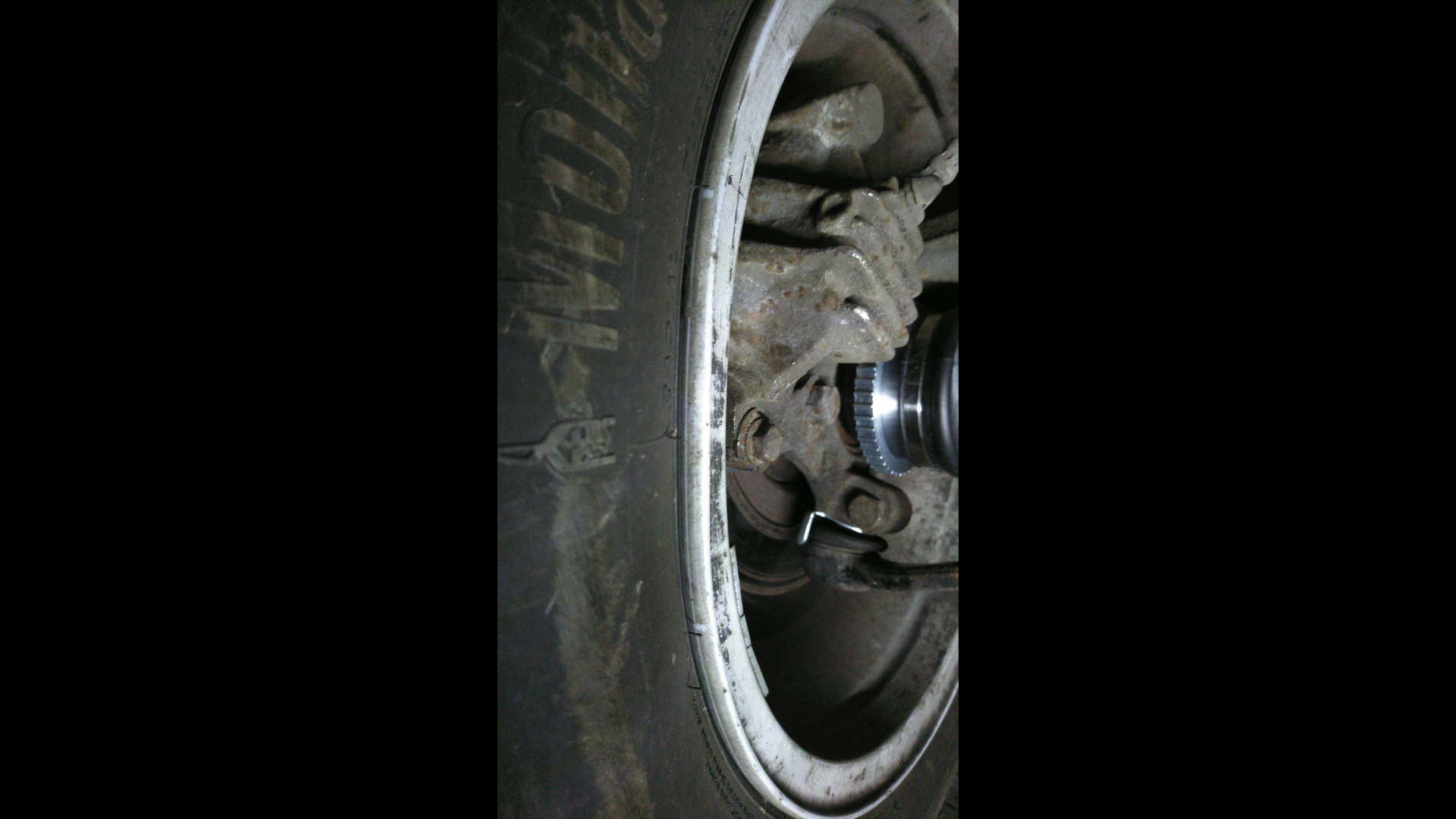

Was happy to find a spare set of wheels kicking about that I hadn't binned, they are the legendary 207's Monacos. Sourced also a shiny replacement one in addition
It was refurbed and I worried about the colour match as it looked truly sparkly, but as soon as it gotten covered with dust, looked just like the old ones Very Happy
You'll notice why I bought a spare by closely looking at one of the old ones:

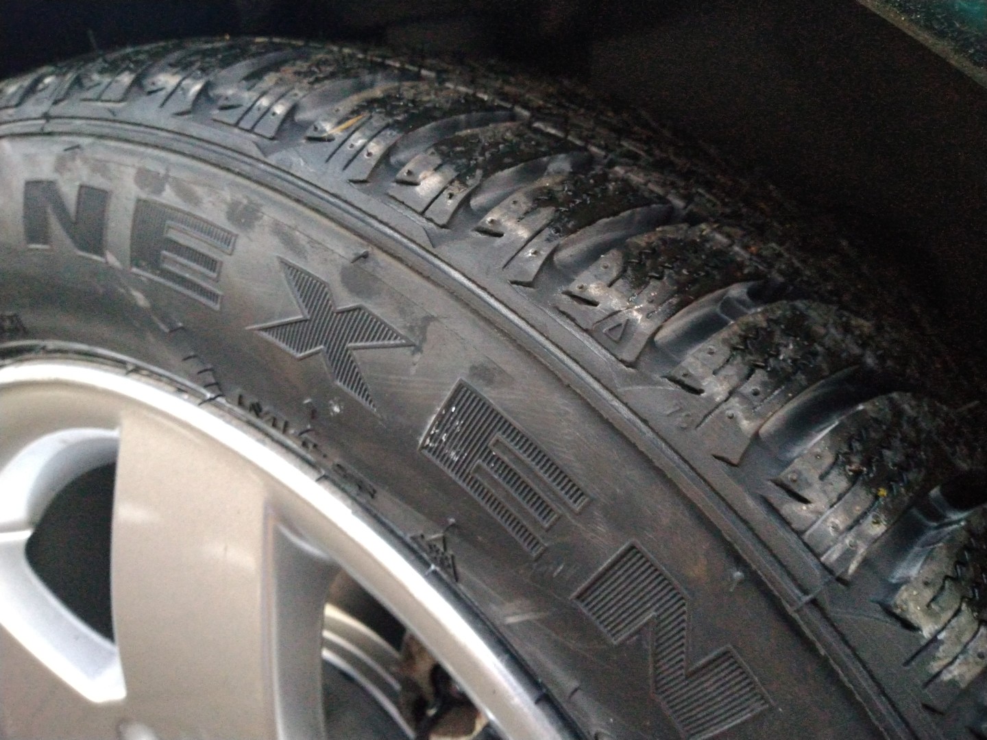

Shoed with Nexen Winguards, had zero issues, still waiting for that snow though DOH!!!

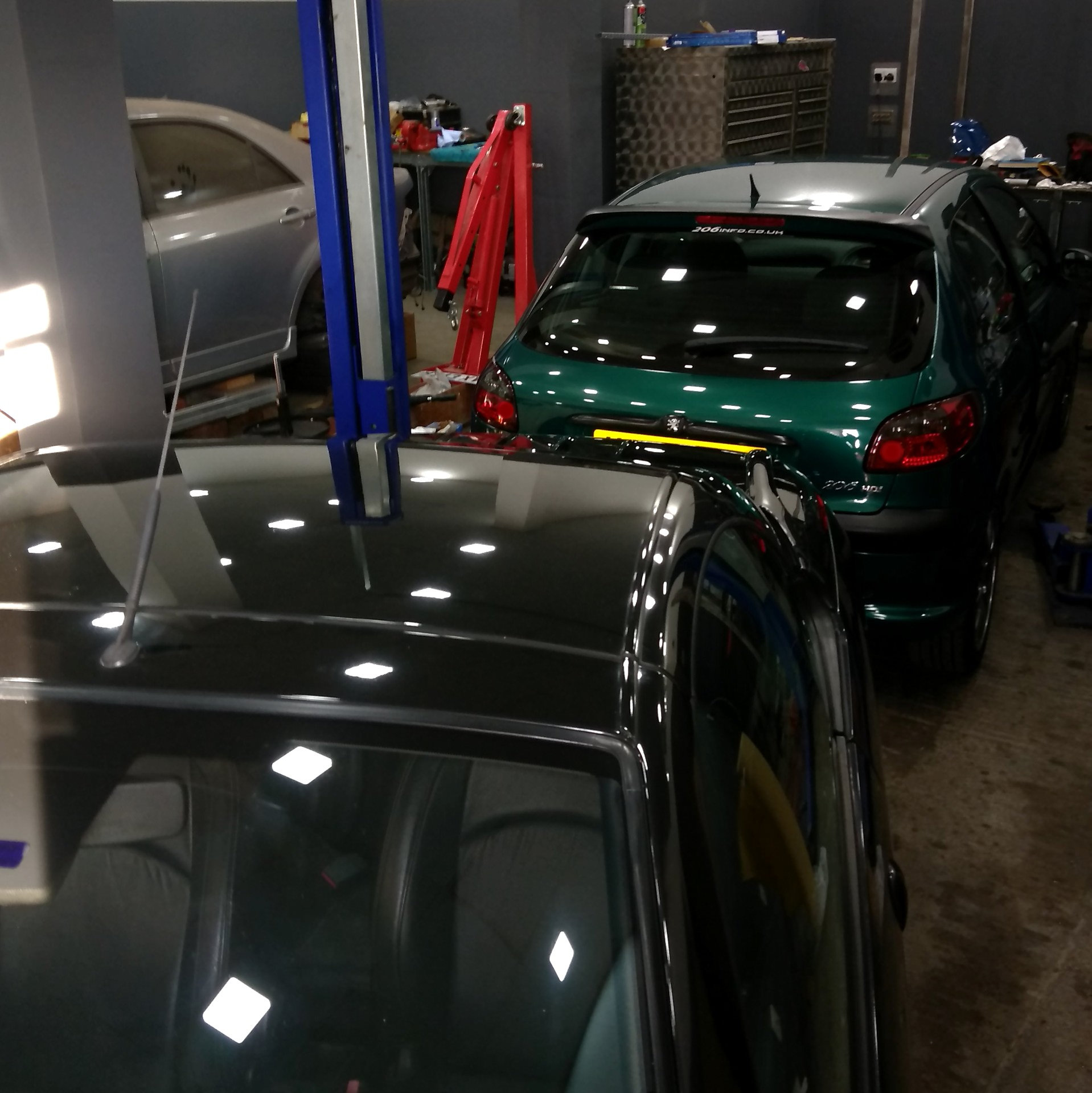

Notice bigger aerial, "kindly donated" by the resting 180, and the pre-mux radio finally packed up, so ripped out a muxed one from the 1.4 HDi (has own screen, so works!), even threw in Connects2 AUX bit from the CC that works too!.. Smile
"When all cars come together" Very Happy
