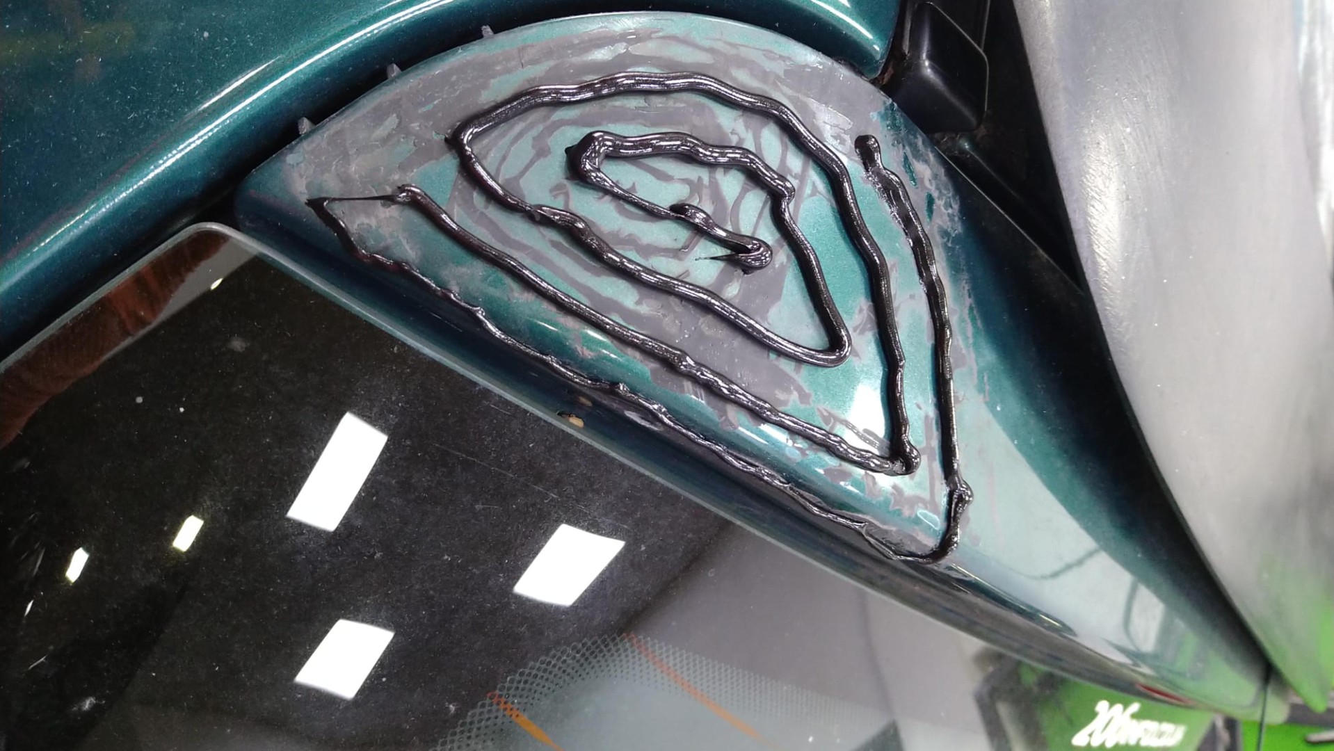

Pugfest prep time!
Seems that the Tiger Seal can hold a rear spoiler for about a decade. Gave it a brief tug the other time and it came right off! Good thing not somewhere on M5 Embarassed

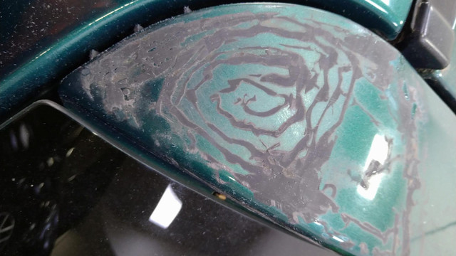

Braided fishing line and the rubber erasure wheel -- that will do to remove the old residue, or so I thought.
That little mark (circled in blue) took a fair bit of wheeling, rubber flying everywhere.
I should've softened the sealant with something like Xylene or tar and glue remover, thought did not have anything to hand; also soaking for too long might mar the paint?
Razor blade to the rescue, carefully took most if the glue off -- happy with that, as the spoiler went back on right after.
