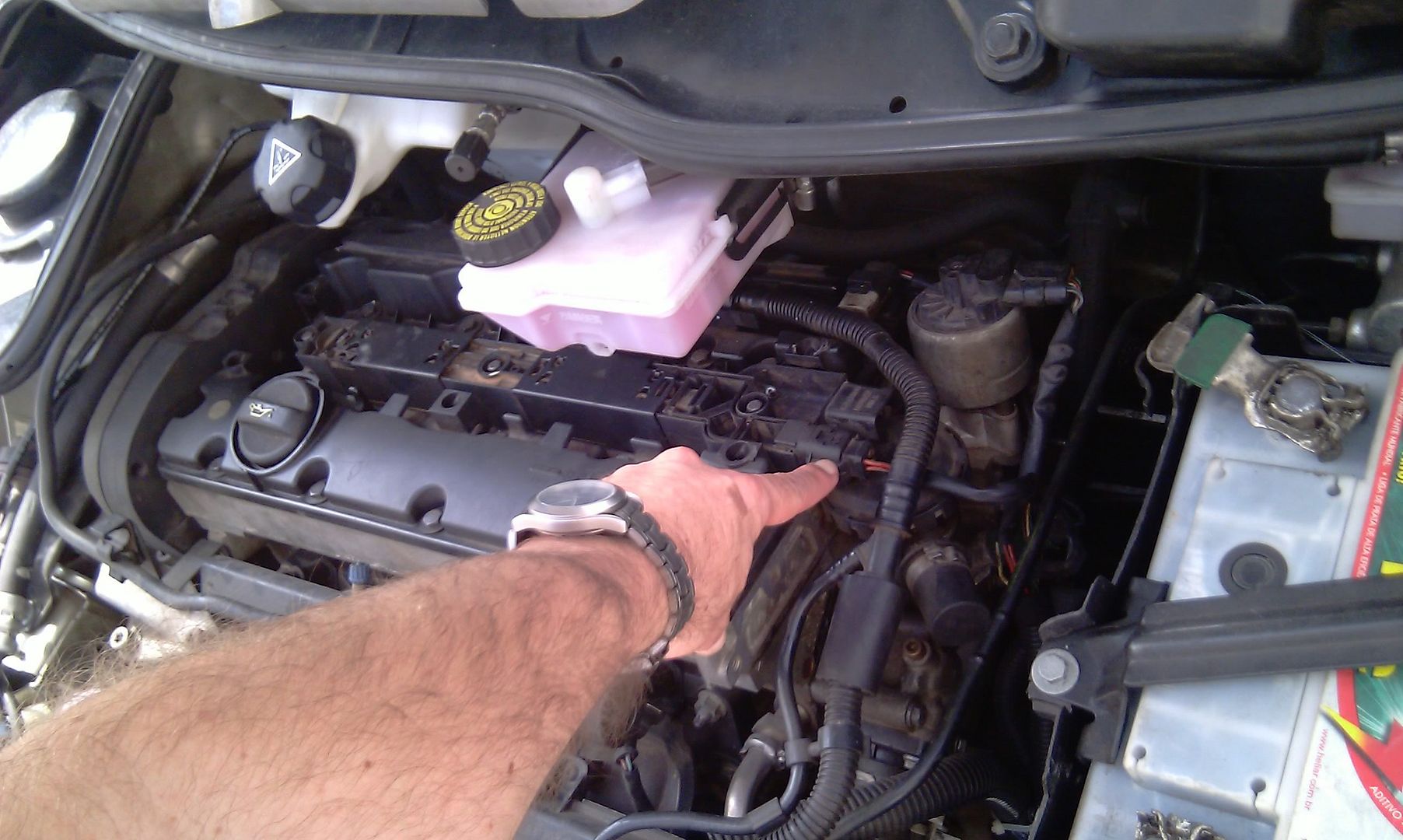

I tried to get the COIL signal coming from the ECU pins . I tried at the coil connector on top of engine (see picture), but there is no way to hook a wire over there. It is sealed. I guess because of high voltage/current. I didn't want to cut any wire before be sure it is there.

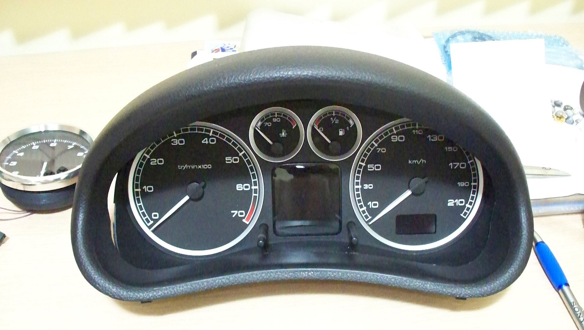

Here is the dash I plan to build: tacho + speedo. Speedo is working. Rev counter is the issue.
Original:

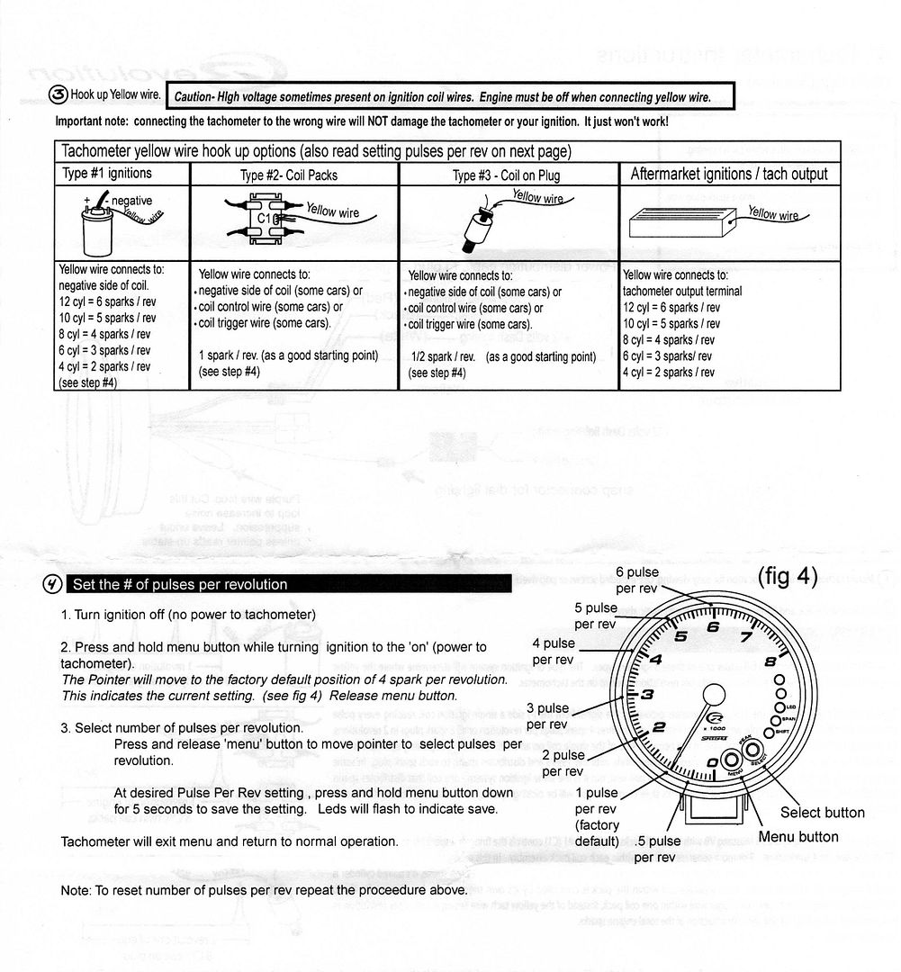

Here is the rev counter installation instructions.
Anyone has any idea or suggestion?
Is that plug on top of engine where I should cut/unwrap the lead to get the coil signal?

- My REV COUNTER manual says to get the pulse from the negative side of the coil. I tried to go them to the coil pack sensor/harness. I tried to connected to cable on the coil connector, but it is a sealed connector, so could not get a proper contact. I them tried in the ECU cable 48V MR into connector with Pins L3, M3, but I could not get a signal. I was wondering if this section of the ECU which sends signal to the coild would be hi-voltage or not. So I didn't strip the wire to get a signal, because I didn't have a insulating tape to seal it back again.
Should I try the ECU signal for the coil pack in that case?

The diagram section that you sent, is directly the engine speed sensor. The REV Counter that I have here says to install and connect to the coilpack , not directly to the engine speed sensor.
Within 4 or 5 days I will be back at home and will definitely strip the wirings going to the coilpack and check if it will work properly or not...
Since the wiring going to the engine speed sensor didn't work fine, I believe in 2 things:
- the engine speed sensor has high revolution frequency , and maybe my REV counter count show the proper rpm. Usually this kind of signal needs to be filtered and processed as a pulse. So I expect that it may be the wrong connecting point.
- the installation manual says to connect to the ignition coil . So I expect to make it work fine doing that...
Will update once I have some news .
