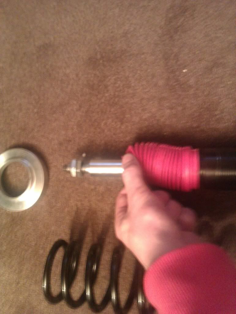

heres some pics Smile
why is one of the top bits pushed right in and the other sticks out a lot should they not both be the same?
sorry bout the crap quality taken on my phone as i left my digi cam charger at work Sad
PostPosted: Thu Jan 13, 2011 2:09 pm Reply with quote Up
is just because the strut is not fully lifted. you don't have to cut the dust shield.
the silver one is the top spring pan. you will need to use oem top mount
btw, how come it is pink! lol

any advice on where to seat the spring to start with and also once seated can i move it to go lower without having to take the whole thing off the car?
how will i fully lift the strut then or does it not matter about that?
it said in the instructions with them that i would have to cut it off :/ i dont really want to though tbh so i will take your advice and not cut it off Very Happy
i understood that i would have to use oem top mount just hope all my bits and bobs are alright like my bearing and that i cant really afford to fork out on new top mounts to fit them to, i should be okay using the old ones shouldnt i? they have only covered 28,000 miles

Those silver top spring seats with replace the old ones. On the picture below the bearing and standard spring seat are fitted together, you'll need to separate yours.
