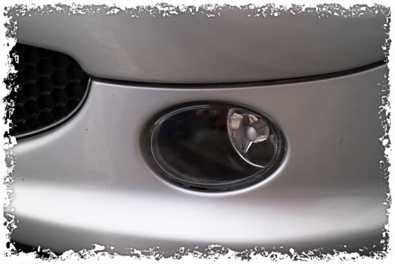

any one any ideas on how to clean the inside glass surface of foglights? - see pic - lots of spots on inside of glass

Take the lake them apart clean and put back together Smile

You sure they're on the inside?
Mine were covered in tiny spots due to stones.

Not 100% sure about fog lights on 206's but if they dont come apart remove the fog from the bumper take light bulb out get a coat hanger or something then thick bit of cloth on the end with meths or something and simply just poke away at it for a while cleaning it, i have to do this with my lights :/

Stick the fogs in the oven for about 20 mins, then prise them apart, clean the insides and re-seal Smile

But there's a hole where the bulb goes in..
Get a hose on the end of it... And then leave it near a radiator to dry...

That would be easier. But prise them apart and you can spray the inside whilst you're there, which looks awesome Smile
