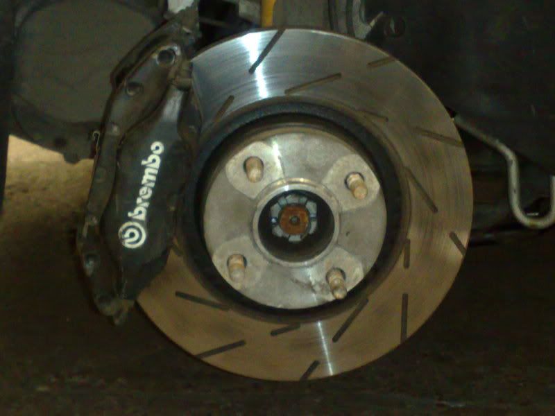

283mm discs but you will still get that horrible squeels as the 406 uses 302mm disc

gti6 are 24mm and 180 are 26 iirc, i dont think the squeeling will stop unless you fit the right size discs (302) i had them on mine and in the end went back to standard. also the master cyclinder needs to be bigger as you will have excessive break travel

thats right if you look at my pic on the bottom outer edge it dont break on it causing it to squeel. if you use 302mm disc you will need a bracket making up. i also forgot you will need 20mm wheel spacers as the caliper will hit the wheel due to the ofset of the 406 brembos
