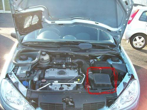

the air filter is circled in RED in the picture below.

On the 1.4 sport, the filter is the long thin black box that runs along the rocker cover on the passenger side. You may have to pull out the air intake (box thing in front of the air filter) to get to all the torx screws though.
im sorry to say your wrong too!
on the 1.4 sport the air filter is located here :

cartoonhead
PostPosted: Wed May 25, 2011 2:29 am Up
Joined: Jun 08, 2010
Posts: 1035
Trade Rating: +17
awwwwww Sad
got that pic of ebay too as its advertised as a 55 plate 1.4 sport Shocked

cartoonhead wrote:
awwwwww Sad
o dear! lol mis advertising! lol
but its as stevesey says failing that get it diagnosed as it could be the VVT getting stuck?
Woohoo, I was right, even if the description was a bit criptic Razz
