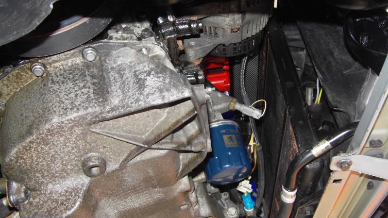

As the title says, what on earth is this connection used for? (pictured, blue wire)
As you can see on the picture, the wire has been cut of/broken, it was connected to the plug (marked with red) which you can see in the right corner (it's located just over the oil filter). The copper was green from oxidation, so it seems like it's been like this for quite a while Confused Anyway, I fixed it up and put it back on - so now I'm wondering what it's for? Rolling Eyes
Also, if you know what the other connection plug (the one hanging loose) is used for, please tell Laughing

PostPosted: Fri Sep 16, 2011 3:12 pm Up
any numbers on the wires?

kinda looks like the reverse light switch but i may be way wrong, can you get better pictures up? failing that i'm sure someone else will know
Harty
PostPosted: Sat Sep 17, 2011 12:40 am Up
This is where it's supposed to sit...it sits on top of the oil filter housing but it's not the oil pressure sensor. It just seems to be a connector to bridge the loom.

Is there a wire in the black trunking in the top right of picture??

Black trunking? you mean the protective thingy? Razz That's the connector I'm talking about, the other part of the cut off blue wire is inside that, I revised the picture for it to make a bit more sense Rolling Eyes - will see if I can get a better pic today.

Is it for the air con pump? I'll have a look at mine shortly.

looks like the oil pressure switch to me..... Check yours Ed. The picture is taken from below and makes it a little confusing. I think its the oil filter just above it.

The the oil filter is in the top right corner, you can just see the rusty ring and the round shape of it Razz
What He Said
The broken wire on the loom, with the engine running touch it to earth & see if the oil pressure warning light flashes up on the instrument cluster Wink

I was looking at the connector in the centre of thepicture which is definately for the air con pump. Didn't see the little red circles.
I edited it after you mistaking, that it was that one Wink So you're not seeing ghosts Laughing
But I did also ask about that connector, I guessed it was air-con anyhow Razz

did you try earthing it??
PostPosted: Sat Sep 17, 2011 12:30 pm Up
Here's mine...
