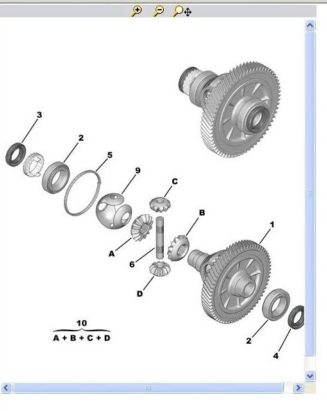

Gearbox (MA) has been dripping oil for ages. I would be surprised if there
is any left in there. Embarassed
I would like to replace all the seals (drive shaft etc) but servicebox is
a bit ambigious regarding this.
Could someone show me on the relevant page which parts and codes
I have to order from my Pug dealer?
Mech will carry out the work but any other advise/thoughts generaly regarding this?
Thanks.

i think there is only 2 oil seal on the box anyway...
both on the differential housing
3121 44 and 3121 46

#3 and #4 below, any other seals that need replacing?

PostPosted: Sat Sep 17, 2011 10:57 am Up
as far as i know that is.
you sure the oil leak is from the driveshaft?
Nope.
But it was definately gear oil. A very slow and small leak over time.
'Will take a better look as soon as I can.
Repair safely - Drive safely

because there is also gasket between the gearbox casting too.

Exactly. I have a feeling it might be from there.

looks like a box off job then Laughing

Wait. I thought you mean #4 on here.
That wouldn't need box off unless I'm missing something?
PostPosted: Sat Sep 17, 2011 2:48 pm Up
4 don't need box off but i mean the surface/gap between those 2 big gearbox casting (non-number in the pic)
normally there is sealant in between
Are you sure about that because the clutch plate etc is above there.
I wouldn't think gear oil would be found in there.
There seems to be no gasket there on the drawings.
Maybe someone can confirm.

not that face....
this face...

better check where is the leakage from first, could save a lot of work.
Yep.
Will do. I just want to make a proper job of it because this has been going on for ages. Small, very slow leak but serious at this stage.
Cheers for the help and I'll keep the thread posted.
