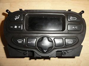

I've got a 2001 206 1.4 GLX. My car has got a the digital climate control like this:
(Image nicked from Google, sorry if it's yours or anything)
Mine has got the black and blue plugs on the back (Don't know if this makes any difference, but I know that there are two different types).
