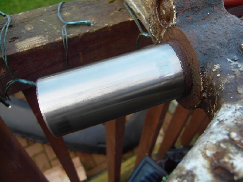

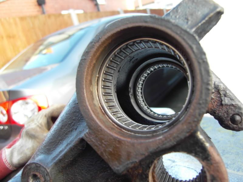

Just as an update here, I stripped the rear axle a little today and found a bit of rustiness inside the rear beam...
There was a nice matching 'patch' consistent with the area of rotation of the rear beam.
My thoughts at the time were that perhaps there was too much of a coincidence that the area of rust looked like it would match up with the consistency of the sound - it only made a noise at certain angle areas (not with the wheels in the air or under a lot of load, but the part inbetween)
So I started to clean up the inner surface
And the same with the end plate outer surface
Did quite a bit more, but don't seem to have taken photos.
After this point, I cleaned up more of the corrosion with a sanding roller on the dremel, then applied plenty of moly grease to the inner and outer ends of the tubing and plates.
Did also put some grease nipples on the arms, but grease gun didn't work. Anyway, all back together and went for a drive over speedbumps and all sorts - noise has now gone completely (or at least for now!)
Basically, there doesn't seem to be play in the arms that I can feel, and I've spent quite a bit on the car lately so don't want to splurge too much too soon. Whilst it's not ideal, and perhaps some replacements should be made with parts, if I get at least a few more months if not 12 out of the axle then I will be in a better position to judge whether or not the cost of a new axle is worth it.
Couldn't remove the end place without tearing the rubber on the outer bush, but obviously it does bugger all anyway judging by the rust inside!

Edward wrote:
So you took the arms off the axle tube?
Yeah, but the noise looks to have been coming from the end plates rather than the bearings... For now.

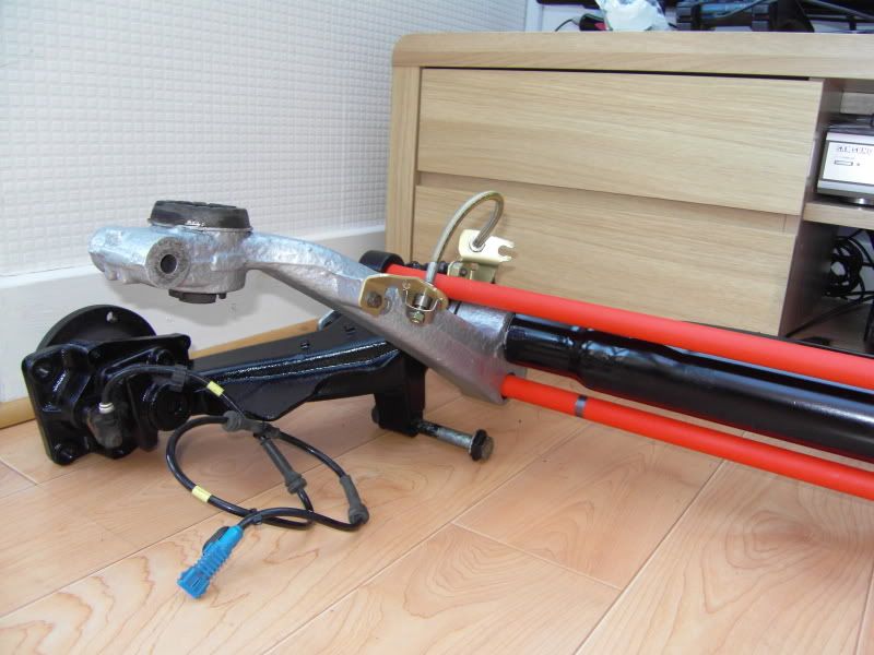

PostPosted: Mon Sep 08, 2014 2:14 pm Up
Posts: 7047
I take it yours weren't this clean?
Which then ended up as clean as this.
badj
PostPosted: Mon Sep 08, 2014 3:11 pm Up
Joined: Dec 17, 2010
Posts: 144
nah, it'll definitely need swapping at some point, but for now there doesn't appear to be any play and the clean up of the lever shaft seems to have silenced it a little.
