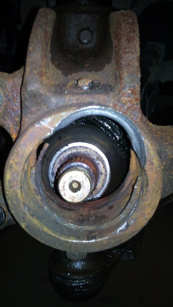

If the inner radius of the hub has worn Idue to long overdue bearing replacement) then fitting a new bearing to a worn surface will be no different a logic than painting a crumbling wall.
Here's an extreme example from an old thread on Passionford (took me a while to find it)
Whilst there's potentially a few possible causes, due to the number of components involved, it's worth checking for play at the rear of the hub - if it's evident that the rear of the driveshaft (at the CV joint) has 'free play', then it only really starts to point to one cause.
This is on the basis that the components already fitted are the correct ones.
The diagrams for example show the only real possible causes based on rear play
It's possible that the Hub Carrier could be worn also, but you'd narrow that down based on visual inspection of the movement.
