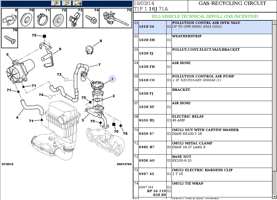

1.1 hasn't got an EGR, it only has pollution control air intake valve near airbox, that's all servicebox gives for the gas recycling part:
Have you inspected ICV (idle control valve), there are several method you should combine to clean it, rummage around forum for instructions.
