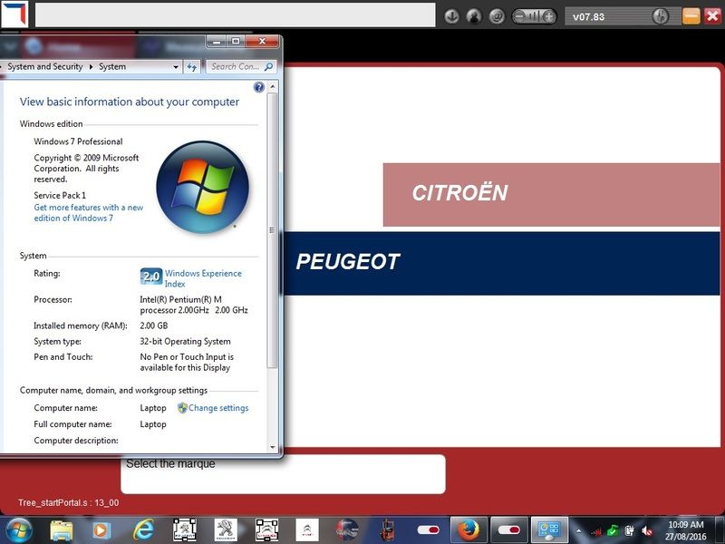

I run Diagbox on a 32 bit version of Windows 7 - no virtual machine required Wink
