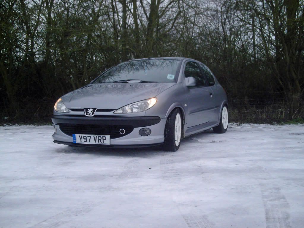

[quote="ben_w_gti"]
PUG1981 wrote:
All,
After seeing on here and other forums the different types of splitters people fitted I choose the Seat Leon Cupra R. Got it brand new from Seat for £24.18 Smile
and 15 mins later this is what it looks like, I know its nothing new but I do like them as it's looks original
Looks well mate, do you have a part number for splitter or did you just ask for a cupra r splitter? sounds cheap to me also as people are selling on ebay for more than that?
The part number is 1ML805903 and it was 24.82 including VAT brand new from seat. They do range in price depending on your local seat dealer but def cheaper than off ebay mate and if you have seat local dont even need pay postage Very Happy

kingdom200 wrote:
ordered mine today really with there was a how to on this lol im worrying bout fitting it now haha
It's simple to fit mate you cant really go wrong just need take you time.
When i got the splitter I cut off all the clips so that the top of the splitter was flat, then driled pilot holes through all the tabs (should be about 10 i think)
Then got the front of the car jacked uo, then use mole grips to holed the splitter in place or a mate.
Then using sel tapper screws started from the centre working your way out positioning it to where you want it to sit, then when your near the edge get a hacksaw to cut it level with the bumper and then put the final screws in the end and jobs done. took me about 20 mins but recommend just taking your time to get ti perfect.
